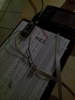

I built a new serial cable and have been experimenting with UART boot.
I got MES_DNW running in Wine, uploaded UART.nb0 and got to the boot menu, but then the application froze.
When I send UART.nb0 in Cutecom at 19200 baud, it just receives a handful of garbage bytes afterwards.
I looked at the source for MES_DNW and it seems to switch to 19200 baud for uploading the boot code, and then switches back to the configured baud rate (ie 115200) once it is finished.
I tried to emulate this behaviour in a Python script using pyserial... when I send and read @19200, I get garbage, just like in Cutecom. When I send the image @19200 and then switch to 115200 (like MES_DNW), it only reads two 0 bytes and then times out.
I also tried micromon from the Leapfrog hackers, but the boot image it generates is 32MB large (from a 30K elf file) - something must be off with either binutils or the linker script (the resulting file should be <= 16K).
