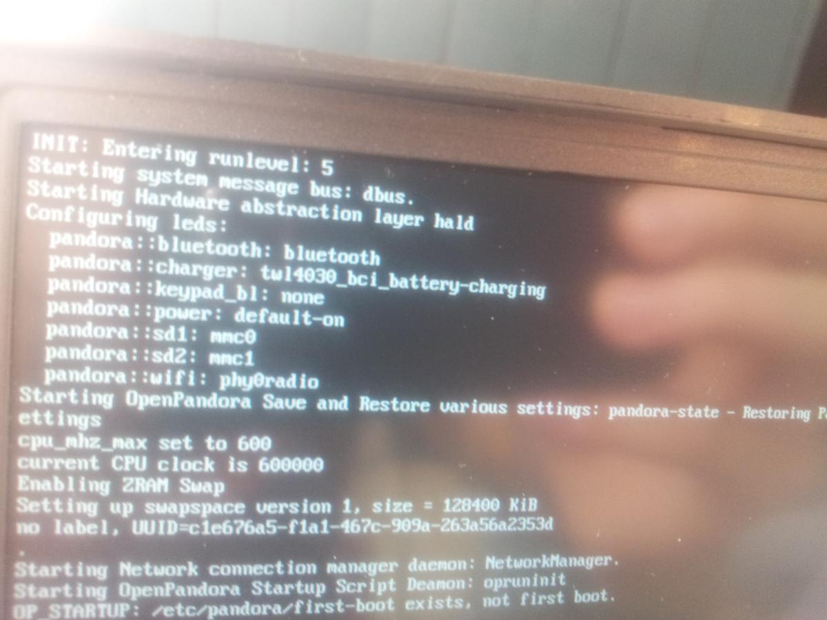

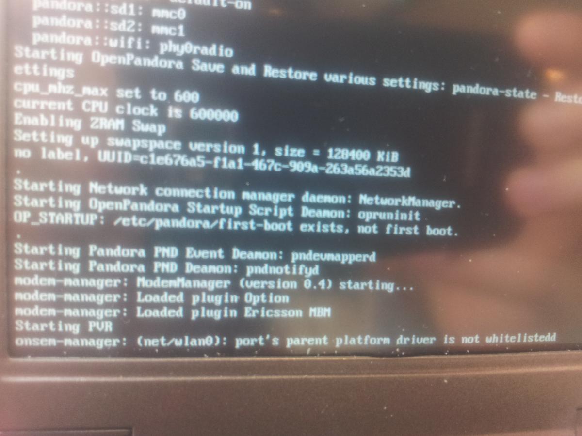

Here's the crash page I get.
For whatever reason it seems to set the CPU clock to 60000
....Lol.
I don't see any error there. To my eyes it looks like the standard boot sequence. Can you get to a terminal there to switch to another tty and do get some proper debug output?
