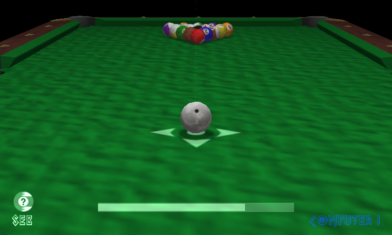

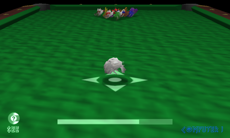

I still have issue, I think it's the glDrawArray with GL_UNSIGNED_INT inside Lists. I must have broken something when I fixed some textures conversion (also, the green part looks suspicious too).foobillard.png

I hope it was a joke yes  :D  .. because release is approching: foobillard.png
Now, that that green texture seems wrong. I have to check on my PC with it is suppose to be like.
Bad weather and bad food, sorry to hear that. Better luck at you next holiday.

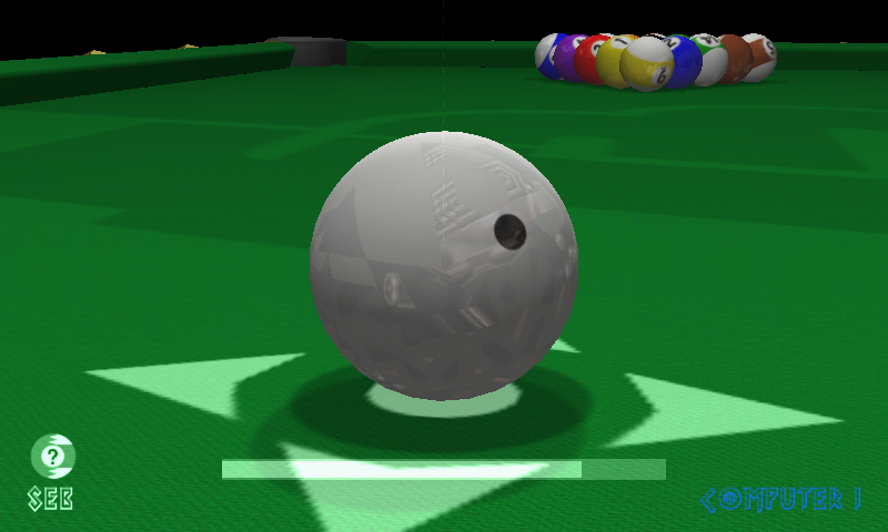

*EDIT*: There are 2 issue lefts: the Reflexion on the ball follow the rotation of the ball (problem with glTexGen inside List I guess) and the wavy green texture is in fact the detail texture, so it's supposed to be much smaller (pb with multiple Texture Matrix, with multitexture, inside List?).
Also, some advanced seting, like Redered reflexion on ball, just don't work (not sure it's easily fixable)... So still some wrk. Enjoy BillardGL in the mean time.

The gltexgen stuff is all kinda experimental.
My foobillard has looked about like your first screenshot for a while now. It used to have plain spherical balls with no problem, and the table's looked a bit different over the history of glshim :)
The broken balls were due the normalize_indices function : you should not remove "min" to all indice (at least not without changing the pointers too).
The other issues are within gltexgen stuff indeed. Both the Ball reflexion and the detail texture.
I do change the pointer, via "arrays_to_renderlist". Maybe we should pass min instead of 0 there?
Ah yes, no changing min & max so they can be used in the arrays_to_renderlist, but still changing the indices value should do the trick! I'll try that.

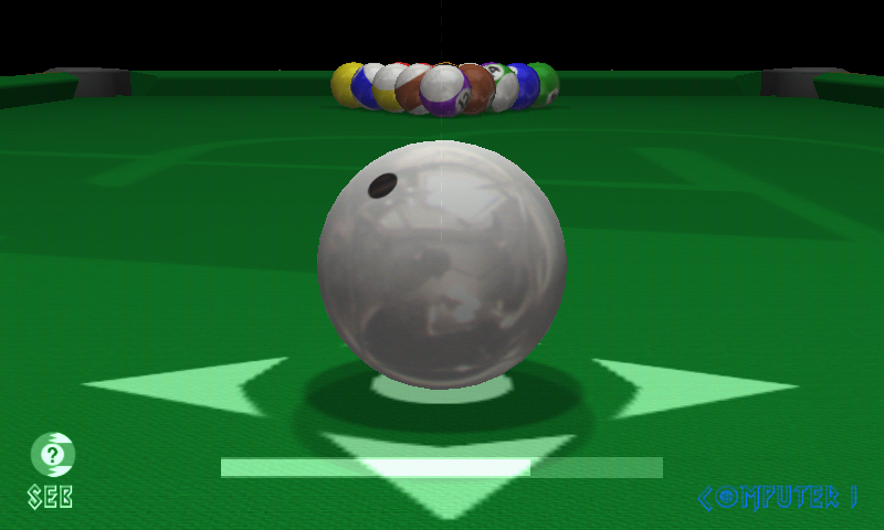

By the way. I'm progressing (slowly) on Foobillard. It's heavy on glList & glGenTex, so it's quite a hell.
I have fixed the table (glGenTex=GL_OBJECT_LINEAR inside glList with Multitexturing) and most of the reflect (glGenTex=GL_SPHERE_MAP inside and outside glList, with and without Multitexture). So reflects on the table are fine. But the balls are not. Still something wrong somewhere... I go to bed and try to fix that tomorrow.
