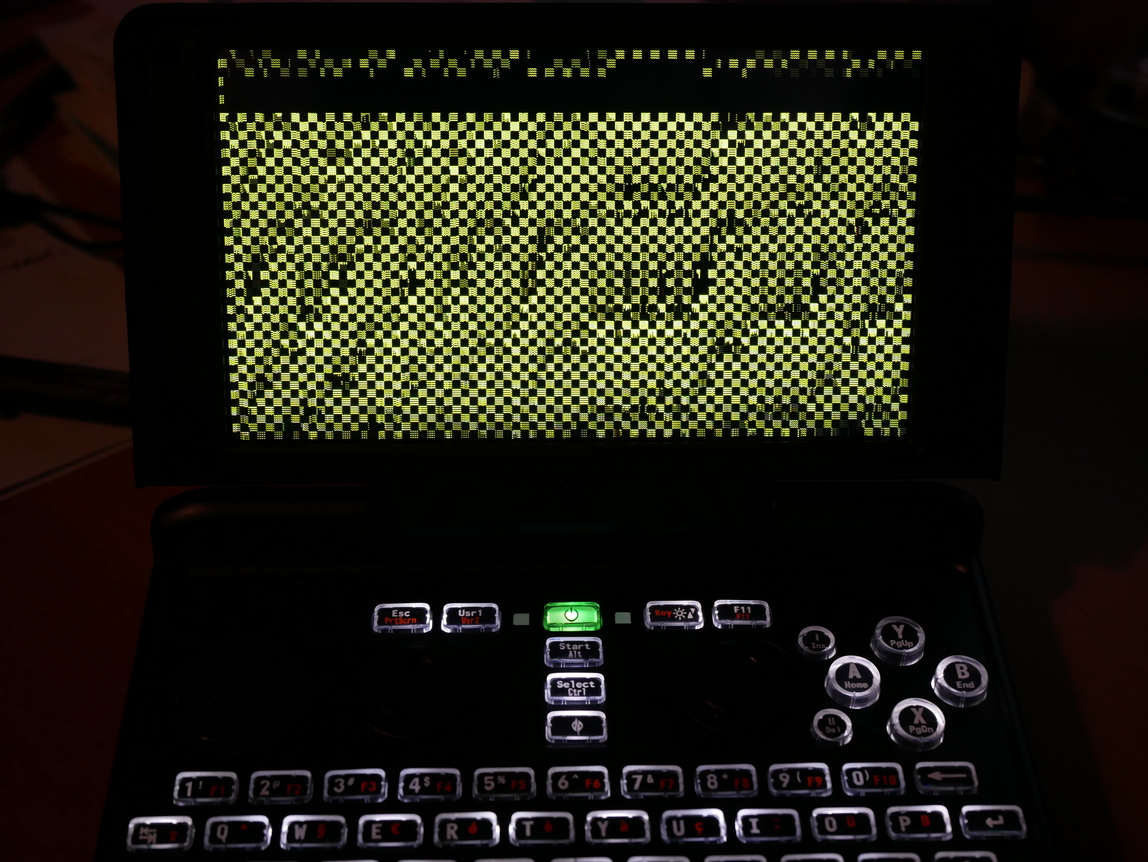

I left it loading over night, which resulted in an unusable system. Boot works fine, but entering the login password works at best for the first 3 characters and the freezes (or freezes directly)

bookworm images starts find, setup begins.
screen calibration, user setup starts, passwd, passwd confirmation starts. No input after 3rd character, and after a moment:

t is not a problem with the lenght of the plan or the linux skills (using UNIX/Linux since 30 years).
The problem is, that the pic from my post occurs at step:
"4. Set up you OS"
At least with the bookworm image on a 32G SDcard

SDcard works. Buster install (pyra-42-install.img) works, bookworm fails. So I guess it is the bookworm image.
result summary:
-buster works (no headphone sound)
-bullseye works once after install (with working headphone), then failed at login screen
-bookworm fails at password setting during system setup
