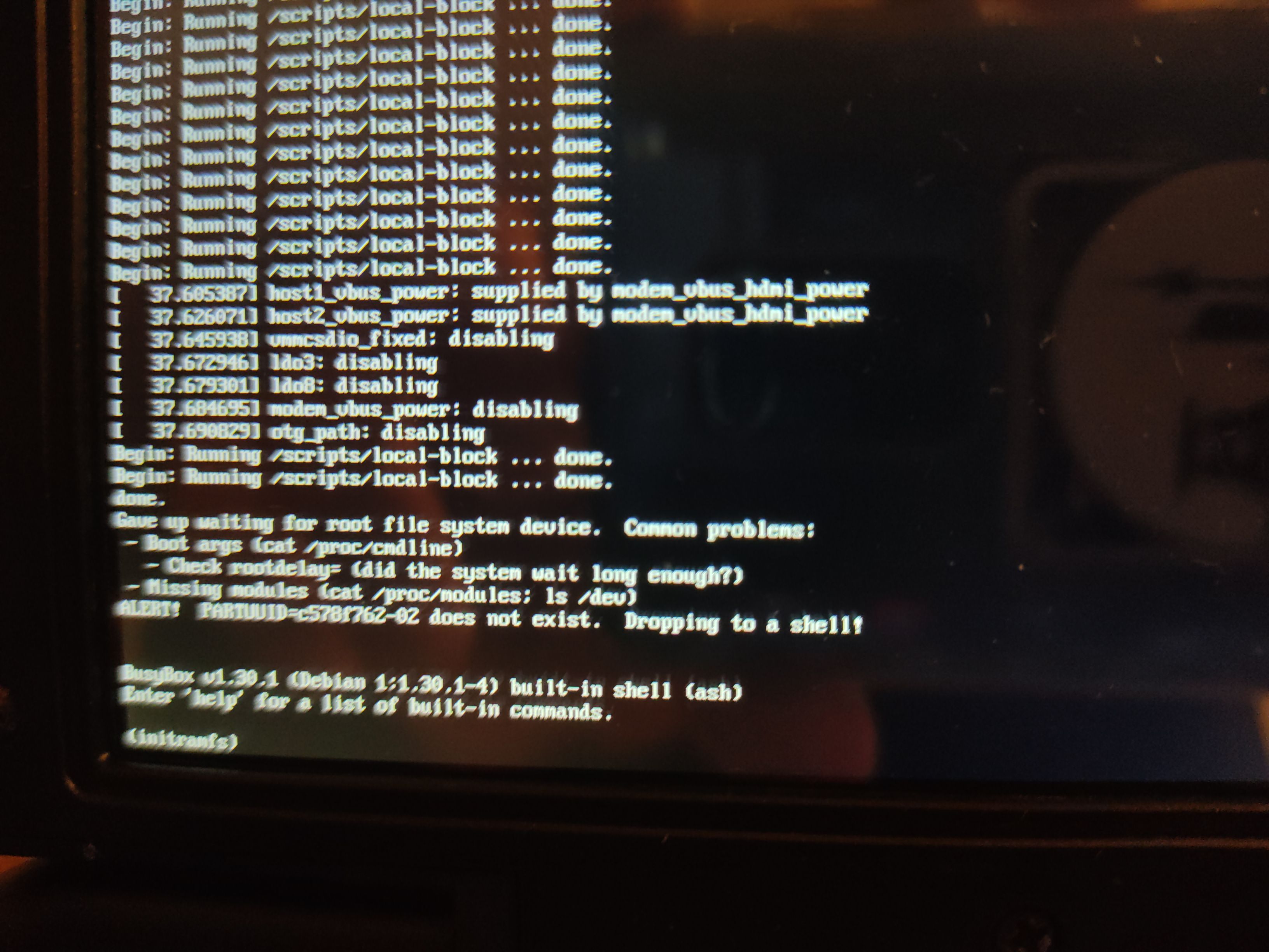

Hi,
all my tries to flash Debian (bookworm, buster pyra42.img) on an SD card ended up the very same boot error. I followed the manual and resized the image as described via fdisk. However does it mean that I have a "bad" microSD card?
Any hints something I missed?
Br
Willhelm

Strange, I followed the instructions above and had no issues resizing.

Might be. I switched SD card once because I did not trust my old one.
** UPDATE **
Ah i was wrong and mixing UUID and PARUUID they differ and are correct in fstab and blkid.
I should read my "screenshot" hrm obviously the boot partition gets mounted but the rootfs not. The Bootloader stated that maybe a rootdelay might help.
I checked the /proc/cmdline there are a few rootwait already included. All this points to "bad microSD card". :|
-> Are there recommendations which Brands of microSD card work? Kingston?

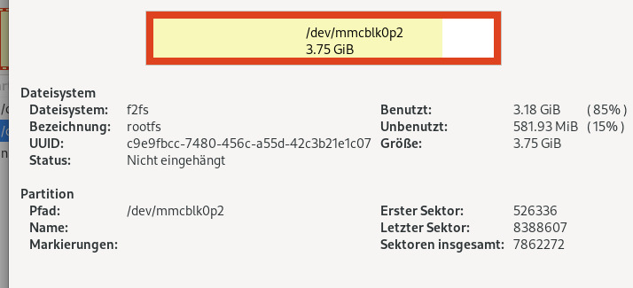

Please take the following only as wrong leading analysis
