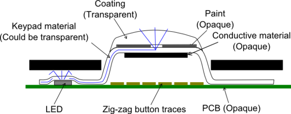

I'm also curious how this would work. I'm no expert, but based on these two images (Board & Keymat) I would guess the button cross section would look something like this:
So, if I'm right, where do the LEDs/lightpipes go and, if I'm wrong, how is the keypad set up and does that aid or hinder the keypad backlight modification?

if the keypad material is transparent then light will travel through it like it does in a lightpipe, so the led only has to be near to the key it illuminates, or you could just use several in strategic locations, if you look at your phone keyboard (if it's anything like mine) there are only a couple of LEDs to illuminate the whole thing, with a transparent membrane and clear text areas where the paint is, you see black text when the light is off, and illuminated text when the light is on, my comment about having a LED for every key was more to imply that there was plenty of power to spare, rather than you need a LED for every key.

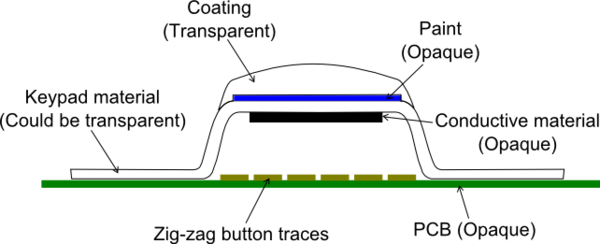

Ah, something along these lines then? Although you'd probably want the paint covering everything except the letters so you don't get light spillage between the keypad and case.
Good Idea, if the transparent rubber itself is the "light pipe", you can enlighten the whole Keypad without the LEDs sitting straight underneeth the buttons. AND you don't need many LEDs. I made a sketch ages ago where I "mounted" 11 LEDs to lighten up the Keypad. Menu Buttons not included:
