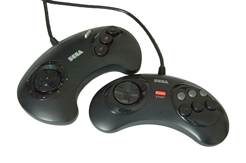

That sounds perfect. My favorite dpad was on the Genesis controlers.
Has anyone actually torn apart a genesis controller and see how they designed the d-pad? :blink:
The actual contacts are on the back side of the pcb! Literally up-side down and reversed left/right!
Most strangest design choice for a d-pad I've ever seen!
I never knew that. I'm totally going to have to open up my spare one now and take a look.

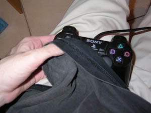

Any Dpad works fine as long as you use Mr Wendal`s patented T-Shirt Method!TM
Step one: get a t-shirt, I like this one:
Step two: place over dpad:
Step 3: Enjoy frictionless dpad gaming! I`m sure this would work with the Panda too.
