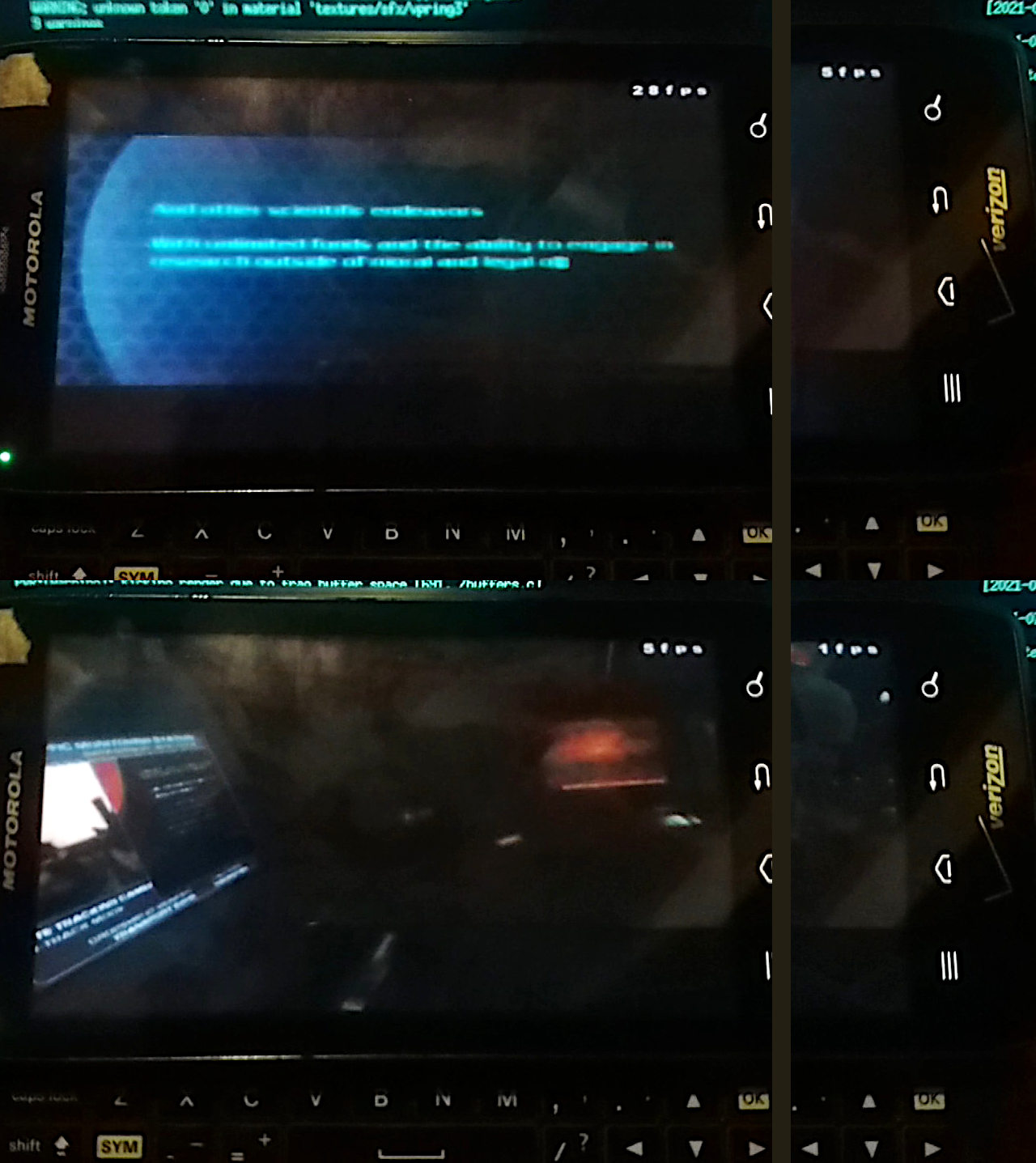

It runs on droid4 now. Menu @ 30fps. The rest, notsomuchfps. :)
One thing I notice is:
--- Common Initialization Complete ---
terminal support enabled ( use +set in_tty 0 to disabled )
pid: 3720
992 MB System Memory
guess failed, return default low-end VRAM setting ( 64MB VRAM )
64 MB Video Memory
Then console spits out a lot of:
writing to: /home/user/.doom3/base/savegames/AutoSave__Mars_City.save
writing to: /home/user/.doom3/base/savegames/AutoSave__Mars_City.txt
PVR:(Warning): Kicking render due to frag buffer space [691, /buffers.c]
writing to: /home/user/.doom3/base/maps/game/mars_city1/textures/objective2.tga
writing to: /home/user/.doom3/base/maps/game/mars_city1/textures/objective1.tga
It seems the config ~/.doom3/base/DoomConfig.cfg is already downsizing textures
seta image_downSizeLimit "64"
seta image_ignoreHighQuality "1"
seta image_downSizeBumpLimit "64"
seta image_downSizeSpecularLimit "32"
seta image_downSizeBump "1"
seta image_downSizeSpecular "1"
