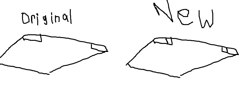

Sure it would. I'm not changing the inside diameter or construction of the hinge holes themselves - just moving the position of the hinge up and back into what is now empty space and plastic. It's just changing the shape of the 'hump' into a trapezoidal wedge and off-setting the hinge into that space.Well, it definitely wouldn't work on the Pandora, as the roll of LCD cable goes through there, and would be crimped and wrecked at the junction between the two hinge parts (or, if the hinge hole was smaller and offset similarly so that it didn't move other than twist, it'd be too tight for the cable to get through). I don't know if the Pyra's slimmer video cable will be more able to cope with this challenge, but given the historic video cable problems ED's had, I'd hesitate before adding any more obstacles.Still looking for feedback on the idea. Anyone?
Yes, this would make the upper rear hinge area 'less round' and 'more square'. But - it may be worth doing so if it adds a precious mm or two around the upper shoulder buttons.
