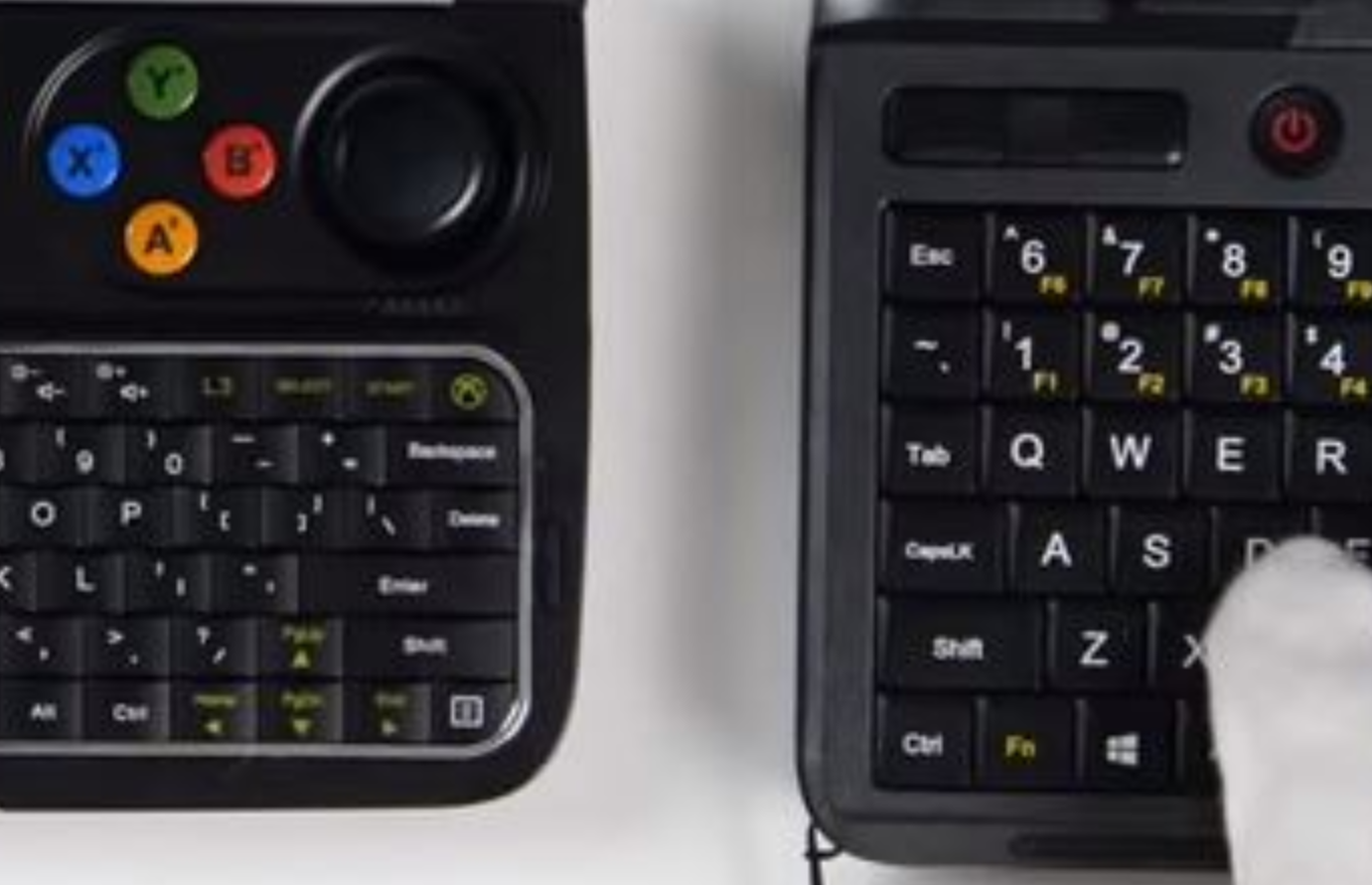

This should give you an idea of how much bigger the keys are on the MicroPC compared to the WIN 2
