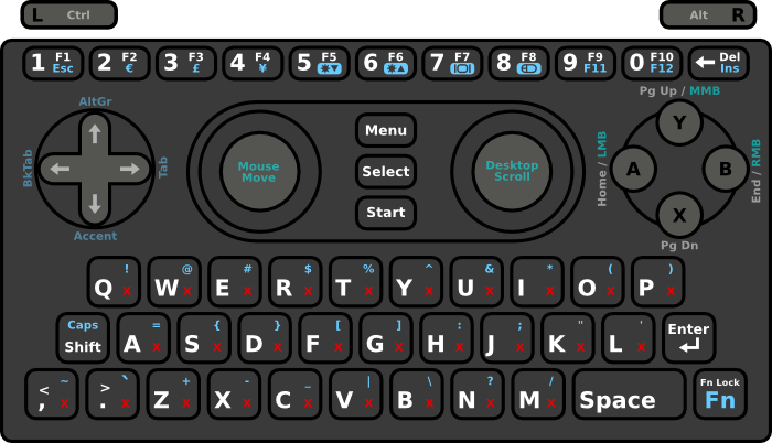

... I believe that it would be a lot easier to use keyboard shortcuts if Ctrl and Alt were on the Shoulders.
-God Ginrai
Perhaps, as long as none of the Ctrl + Alt + xxxx combinations were not in the bottom left or right corners of the keyboard. Then it would be a little awkward. It may be best to have L / R function as such since it frees up two keys and more importantly kind of makes sense, as in is intuitive.Ctrl Alt on the bottom left as previous layouts have suggested is a little more easy to figure out, but once you get used to it, it really doesn't matter.

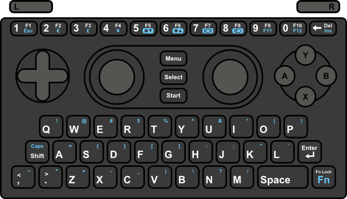

I'll only need to remember one hidden keypress Fn+Menu=SysRq :) I hope that I will not forget it in a moment of stress when Pandora will hang (That's why I'd prefer to see it printed on the keyboard ;)).
Only one aesthetical correction - since it's going to be printed on Pandora, the labels around Dpad and ABXY keys need to be rotated:
SVG source
I didn't delete red 'X'es here, bout I'd like to :) And IMHO there's no need to write "Space" on space.
I tried with a scale 1:1 paper mockup of Pandora. It's only awkward to press Alt-Ctrl-[F,G,V,B], but possible. Other keys seem to be ok.
I thought the muted coloured keys were not going to be printed?
I also liked the Pandora key instead of the word Menu.
cosurgi said:
SVG source
I REALLY like that layout. :D

Hmm? Trying it here, F,G,V,B seem perfectly reachable on this end. Depends on the size of the hand, I guess? I was hinting at as long as the keyboard was done in a way that you never ended up lets say, doing Ctl-Alt-Fn on your layout, it would not only be ok, but actually a very nice way to arrange the keys off the keyboard. Initially I was against using the game controls as keys entirely, but I'm pretty much convinced now too. Thanks for throwing the Yen (En) symbol on there. : )
Edit: Desktop scroll? You're assuming we're going to be using "Virtual" in our X config? :p

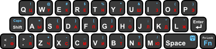

My to cents here. Please make standard qwerty layout as default. Stickers + software reprogramming can solve any layout issue with any language. Why do we have to have an accent button mapped buy default? Is it that necessary to overload keyboard with 4 sings per key? You want to please non-English speaking people but is it possible?
For languages based on the roman alphabet this is what you should get.
Foreign symbols & accents are mapped to Fn-Up & Fn-Down, which aren't even labeled. Does it still seem too heavily focused on multilingual support?
QUOTE

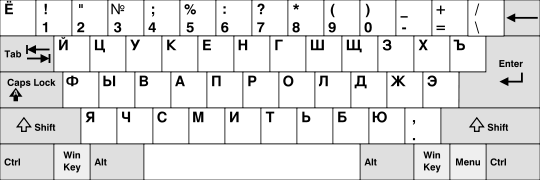

Let's take Russian layout as an example. We know it's impossible to make a Russian layout that'll be comfortable to type. [...] But do you think it's possible to quickly work out a Russian layout that will be as widely accepted as qwerty?
It seems to me there is already a fairly standard Russian keyboard layout:
Fortunately it maps almost entirely to the alphabet keys. The Pandora is about 4 keys short, but with some symbol overloading and use of accent mode as well, it should fit on pretty well.
(Something like Chinese or Japanese wouldn't work, but they've got good roman-based input methods anyway.)
And again, this is just about allowing for localization; we're trying to make it possible, not forcing it onto every user.

Looking at the Cyrillic keyboard above, it actually looked pretty easy to set up. So with the help of Wikipedia I gave it a go.
That's 28 of the 33 characters needed.
Accent-Е for Ё
Accent-Ш for Щ
Accent-И for Й
Ъ and Ь are apparently placed after a consonant to modify pronunciation, so I thought Accent-<any consonant> could add those symbols, software permitting.
Any Russian users care to offer feedback?
