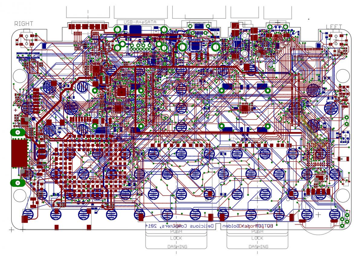

After spending hours and hours and hours of time, Nikolaus finished V3 of the main PCB.
That PCB will be produced during this week and it will be ready for the Gamescom :)
It's almost the final main PCB revision and will be used to test all functions and find any remaining bugs.
If all goes well, V4 will be the one that is going to be used for the main production!
If you want to see the amount of traces needed to create that PCB... go ahead :)
(of course, when you are working on it, you don't need to see all traces at once ;) )
And if you want to see what's taking so long to design such a PCB... how to puzzle a PCB together, so that no traces get in the way of others.
Here is a small video. It's running at 10x speed - so you can imagine how much exhausting work this is!

Next for Nikolaus is to continue to work on the LCD drivers, so we can finally choose the LCD as well.

This is the PCB where the SD Card Readers, and the Keyboard is, right??
Good to hear its finished,
But what about the CPU PCB??
This could be a bit more divicult than the Main PCB because it have lot more layers..

A lot of the CPU PCB has been designed already as well.
However, it's not necessarily as difficult - more layers make your life more easy.
The Main PCB was so difficult because we wanted to keep the layers as little as possible (saves a lot of costs).
There are a given amount of traces you need.
And these traces should not interfere each other and have other technical needs as well (i.e. a maximum length from one component to the next one).
Doing this with multiple layers is easy - as you can simply move your traces to a different layer.
But with ONE layer, this is a lot harder.
So basically:
For the same amount of traces, adding another layer makes things more easy.

Wow, if an 2 layer PCB already looks that complex in X-ray mode, how will then the SoC daughter PCB with it's 6-10 layers look if all layers are visible.   :ph34r:  When it's ready, you need to post pictures of that too of course. ;)
Wow, you are using EAGLE for this...
You know that with Altium Designer the design process (of both PCB and schematic) would be at least 3 times faster? Altium is more than 3 times more expensive though, but it's worth it.

May I ask what big component lies directly on the right side of the board (left side on the picture), in between those two green '+' markers ?
Maybe it's the 3g module. If I remember correctly, 3g must be placed on the edge, am I right?
Would make sense > depending on what you define as "module". Afaik the big chip on the right side of it should be responsible for actually doing the mobile magic, while the "filled rectangle" could be the antenna.
