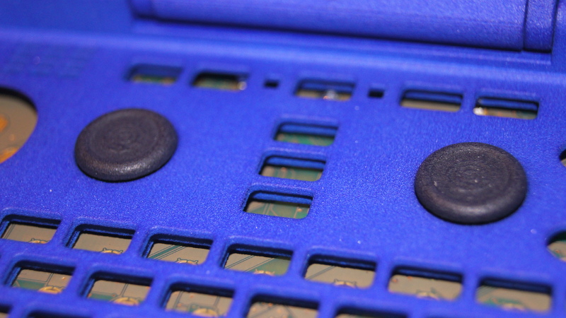

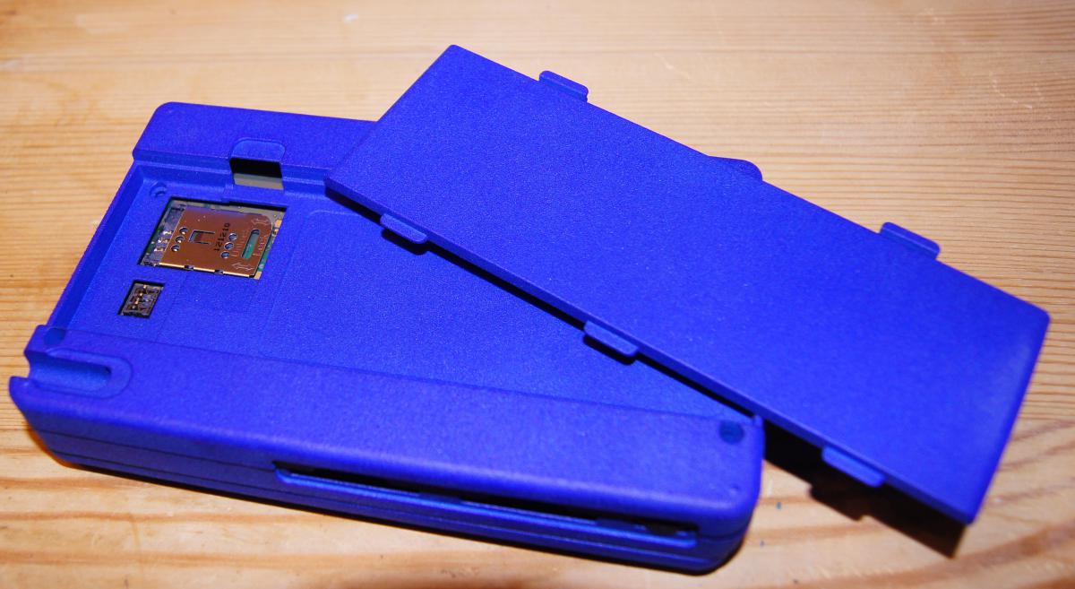

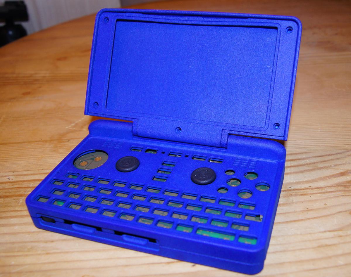

4. Case design
As you already know, a basic case design is finished that's good enough for testing the available space for the CPU PCB as well as seeing how well the main PCB does fit in.
Of course, it's far from being finished, and while Nikolaus will use that one to continue working on his PCBs, the case designers are working on the remaining details.
They'll now work to implement the logo in the lid, add the shoulder buttons and do some minor tweaks of issues we found (though those actually are not many!)
First they'll finish the keymat design though, as that's needed to find a company that produces the keymats for us.
I've added some nice hires shots of the current 3D printed case for you :)

How about the battery? Have you tested the space for it yet?
cinaeco
Feb 20, 2014
27
Thanks for the update! Can't wait to see how the CPU PCB works out.
Yeah, I'm wondering about the battery as well - any update on how the regular and larger batteries go with the case?

The nubs look very smooth and operable the way they stick out of the case :)
Looks like a step up to the already comfortable panda nubs.

Anyone else thinking that the space to the right of the SD card slots looks a bit empty?
Obviously we can't put more electronic stuff there (because of the 3G antenna and such).
How about a slight recess where you can put a sticker with a logo and model number (since the same case may well be used for different CPU-board versions) - or the owner can write their name?
