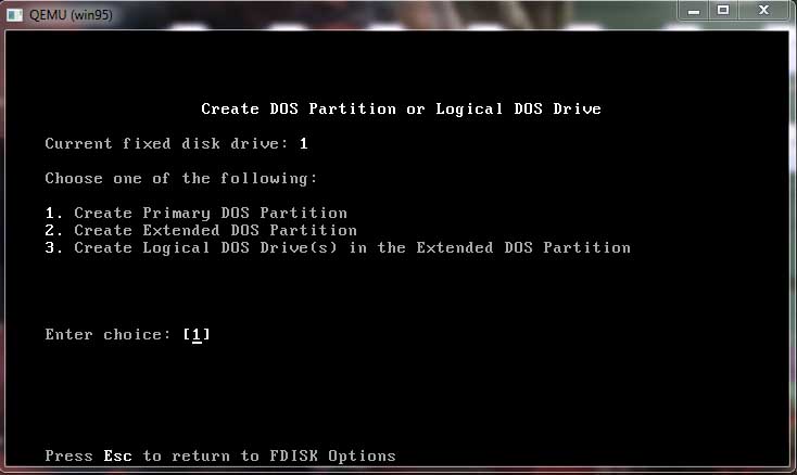

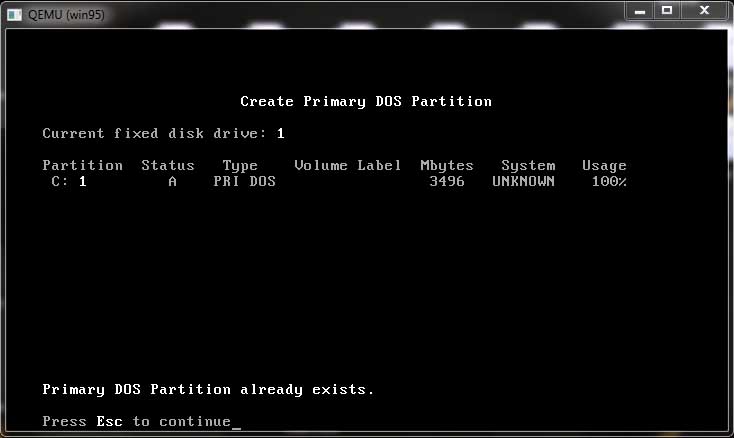

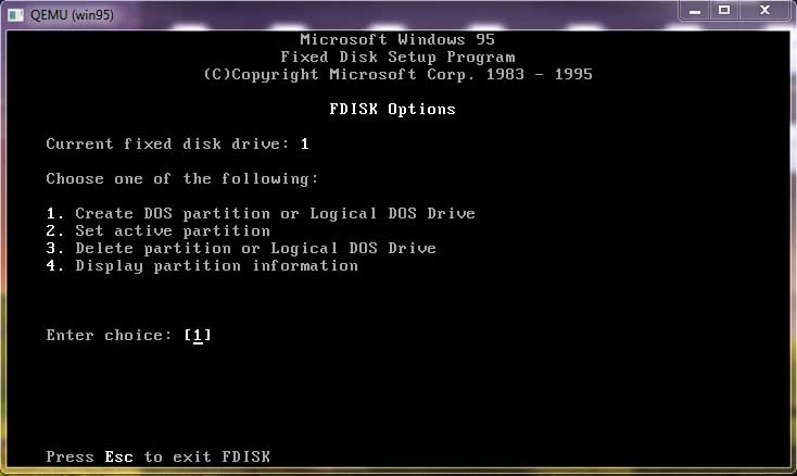

I used fdisk...
Trying to run setup after this I get the same errors.
Everything looks good, in the config.sys and autoexec...
if this is successful it should of enabled the D: drive and allow you to run the windows setup from the D: drive.
mcobit made a typo.. there isn't anything called ados.. he meant a DOS 6.22 image.
FDISK only makes the partition, which it's saying is already made.. you will need to format the C: drive.. at the command line try this..

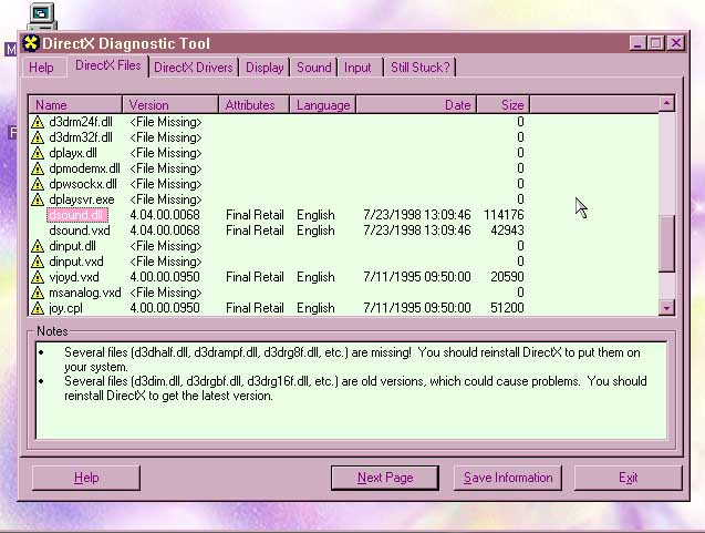

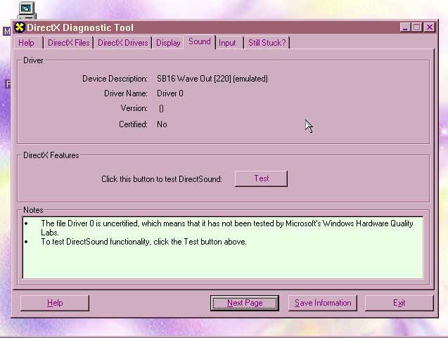

Maybe your Sound work better when you start in windows95 the Programm DXDIAG.EXE and Disable Sound Hardware Acceleration in it.
That helped me a lot with Sound Problems ;)

For some reason there was no dxdiag.exe in my win95 install... I had to download it.
However, I see nowhere I can Disable Sound Hardware Acceleration:

Dxdiag is part of later directx versions and may not work with the early dx6 you have installed.
