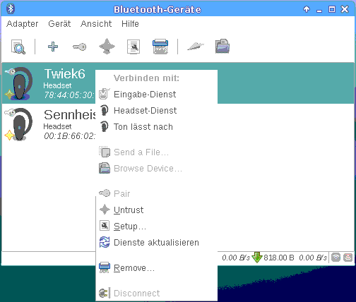

  • Find your device's MAC address:
    Enable bluetooth on the pandora and activate your bluetooth device (e.g. your headset) so it can be found.
    On the pandora a window should pop up, the bluetooth device manager:
    If it doesn't pop up, open it manually with:
    Code:
    blueman-manager
    You can also use:
    Code:
    hcitool scan
    Code:
    hcitool con
    Search for devices and write down their MAC addresses -> XX:XX:XX:XX:XX:XX

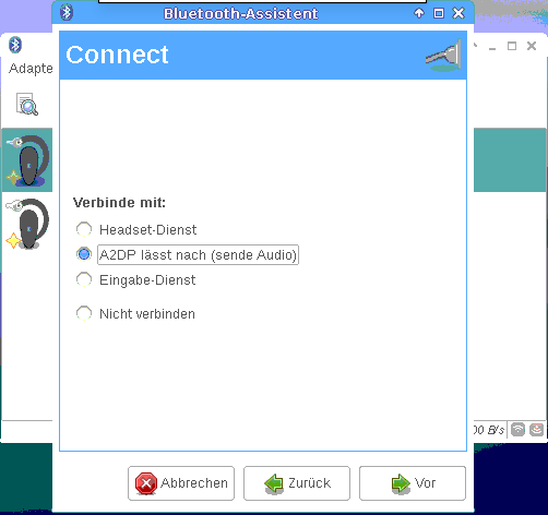

Pair your devices
Open the bluetooth device manager again.
Right-click on your device. Click on "Setup":
Connect using the A2DP protocol.
If you're asked to enter the PIN code, try: 0000
If that doesn't work go study your device's user manual.
Hopefully your device gets connected. Click the star button to "trust" that device.

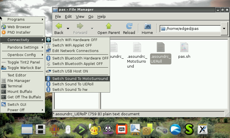

[doublepost=1459121320,1459094877][/doublepost]Does anybody else run Openbox?
Since kickass was so great in providing the script/framework that everyone can use for switching asound config files, I decided to integrate the script into my openbox menu configuration. My configuration checks if you have the script installed to "~/pas/pas.sh" and if you do, it reads all the .asoundrc_* files you have saved there, and lists them as options in the Connectivity section of the menu.
Simply replace the togglemenu function in /usr/bin/openbox-functions script with the following:

        echo "<action name=\"Execute\">"
            echo "<command>openbox-functions bluetoothapp_$bluetoothappletstate</command>"
        echo "</action>"
    echo "</item>"
    echo "<separator />"
    echo "<item label=\"Switch USB Host $usbstate\" icon=\"/tmp/iconcache/op_usbhost.png\">"
            echo "<command>sudo openbox-functions usbhost_$usbstate</command>"
        echo "</action>"
    echo "</item>"
    if [ -f ~/pas/pas.sh ]
    then
    for asiter in ${asoundoptionarray[@]}
    do
    echo "<item label=\"Switch Sound To $asiter\" icon=\"/usr/share/icons/hicolor/32x32/apps/bluetooth.png\">"
            echo "<command>~/pas/pas.sh -o $asiter</command>"
        echo "</action>"
    echo "</item>"
    done
    fi
    echo "</openbox_pipe_menu>"
