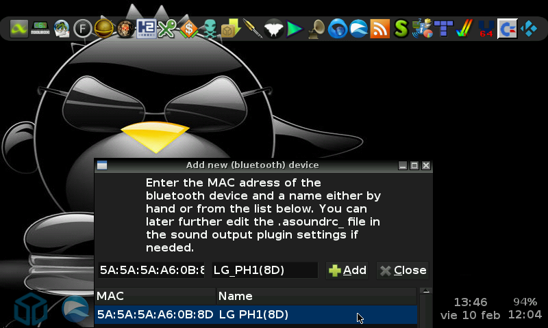

I did a few test with my bluetooth speaker (thanks Santa) and it seems it didn't like devices with parentheses on the name, like LG PH1(8D).
I did remove (8D) from the name, and it does change .asound but how to make the programs to output to the bt speaker? I don't see any other output on QMMP, SMPLAYER, etc.

theres no need to change the output mode as long as your progs use alsa for sound output. pas sets the device of your choice as default device. so, as far as alsa is concerned, it will use that device.
dunno about qmmp, but smplayer should work fine.
Ah, thanks! I only checked for " and spaces, I will add a check for paranthesis, too :)

@canseco: Okay, I hopefully fixed the parantheses bug for you. If you click a name with parantheses, they are converted to underscore. And even if you type them by hand, it will not let you create such a device. I did the same for asterisks.
The reason is, that I call a bash script in the background and I would need to escape these letters. Well, it's easier to to forbid them. :>
