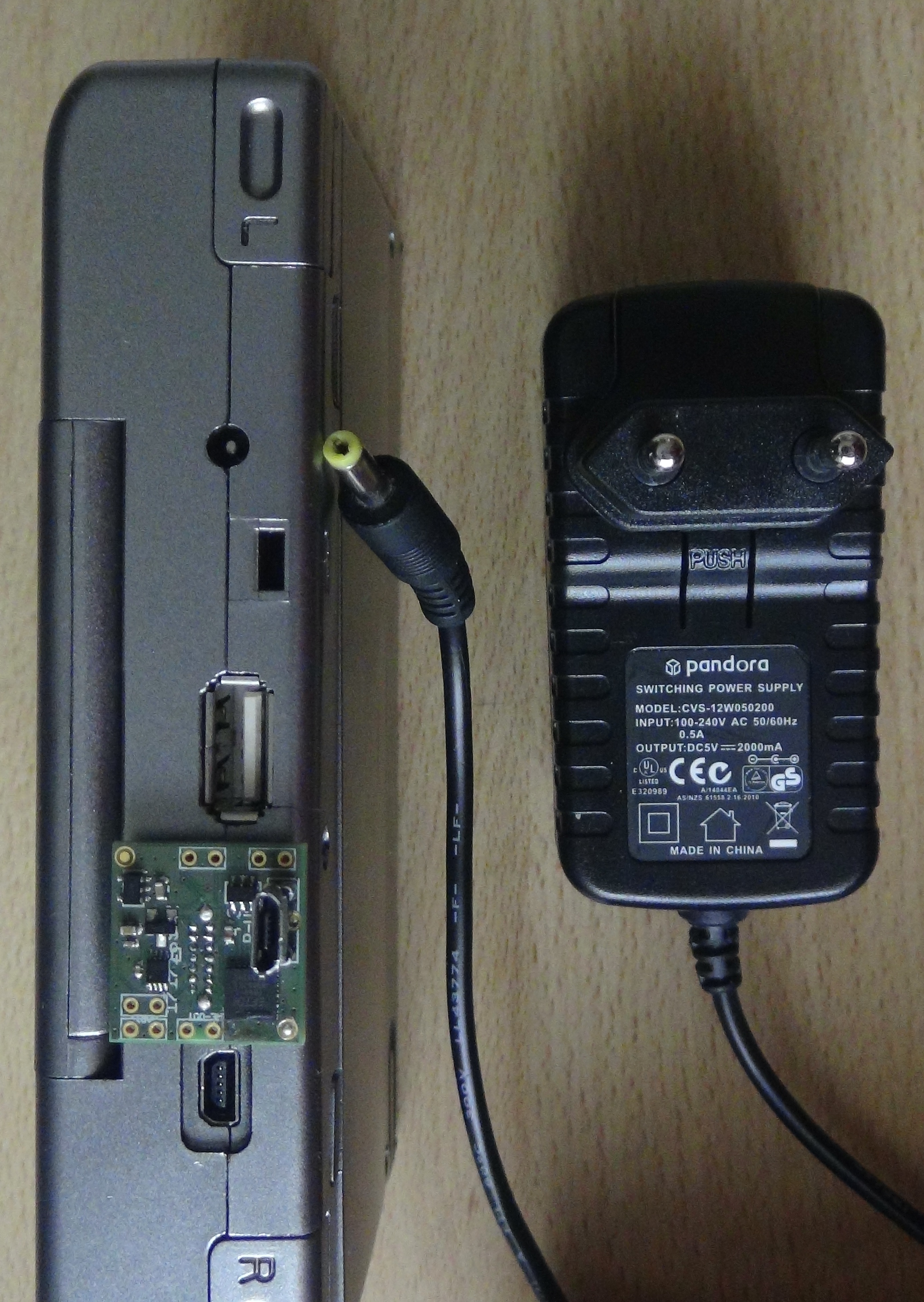

How the original looks like
AFAIR 5V and 1A or even less is enough for charging as it is limited by the internal charging circuits (TWL4030 chip).
For the USB port, USB2 usually only supplies 500mA and this is still enough. You can use an USB-C power supply with Mini-USB2-adapter (cable) since it must actively switched to higher voltages than 5V which is beyond the capabilities of the Pandora.
But I recently had a completely drained battery and the Pandora didn't wake up on USB charger. Maybe USB charging must be activated in the boot software. Which doesn't if the Pandora does not even wake up with drained battery. Locating and using the charger helped.
