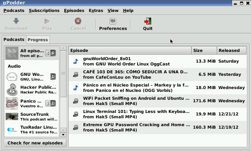

Since the update to the latest firmware (SuperZaxxon 1.6) gPodder won't start. :(
As i said in comments on the repo, i'm trying to fix it, but no luck so far.
Debug says: "No module dbus found", but python-dbus is installed, and if i try "import dbus" on python console, it works.
If anyone would like to test it, I have made a working version of gPodder. Since the PND worked when Codebolcks was mounted, but presented the d-bus issue when it was not, I tried pulling libs (found using lsof) and sticking them in the gPodder PND.
From what I can tell, python would complain there was no d-bus if there were other libs that were missing that d-bus depended on. It was hard to tell what was actually missing though...
I could probably use some help customizing with support for some of the more common media players, maybe adding smplayer2, and I need to clean out a lot of the redundant libs that I added while trying to find out what was missing.
This PND depends on ptitSeb's wxpython PND as well. I might be able to make it standalone, but this works for me for now.

Okay here is the latest PND. Unmounting is fixed, thanks to @ptitSeb. I packaged scripts for deadbeef and panplayer2 support. Simply type in "deadbeef" and "panplayer2" for your default audio and video players.
The "Enqueue in media players" extension also works with deadbeef. This gives you the choice in the context menu to either play/stream the selected episode or add it to the current deadbeef playlist.

Still not sure why some icons are missing...
