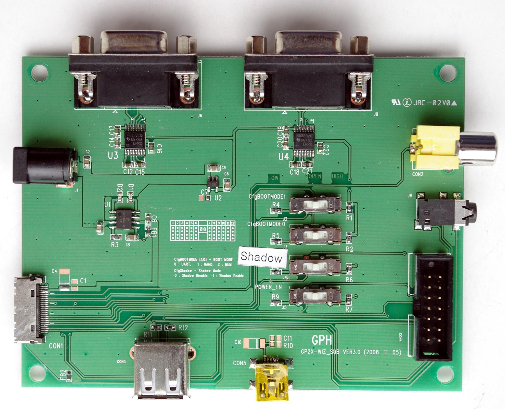

I was looking at how to Unbrick -
The pictured Dev Board - Is it the same connector as the GP2X Dev Board?
It looks SIMILAR!
Could a GP2X Dev Board be used to Unbrick a WIZ? Can someone with some more Knowledge jump in.

I have a GP2X BoB in my lounge room draw with the supplied cable.
GP2X BoB:
No, you can't use a GP2X dev board. You can't do it with just a serial connection anyway, you need extra pins to force the Wiz to boot over serial. I could try it if you want, I have one of the original developer boards and have done it before on my prototypes but if you're outside the UK the postage could cost quite a bit.

I know this wouldn't be possible for most people but could the chip that holds the firmware be unsoldered/removed and then programmed using an Eprom burner then re-installed ?
Probably, but it'd be easier to build the serial cable with boot mode pins exposed.
