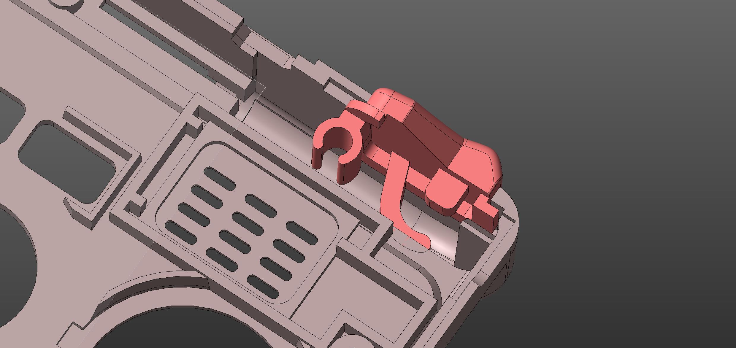

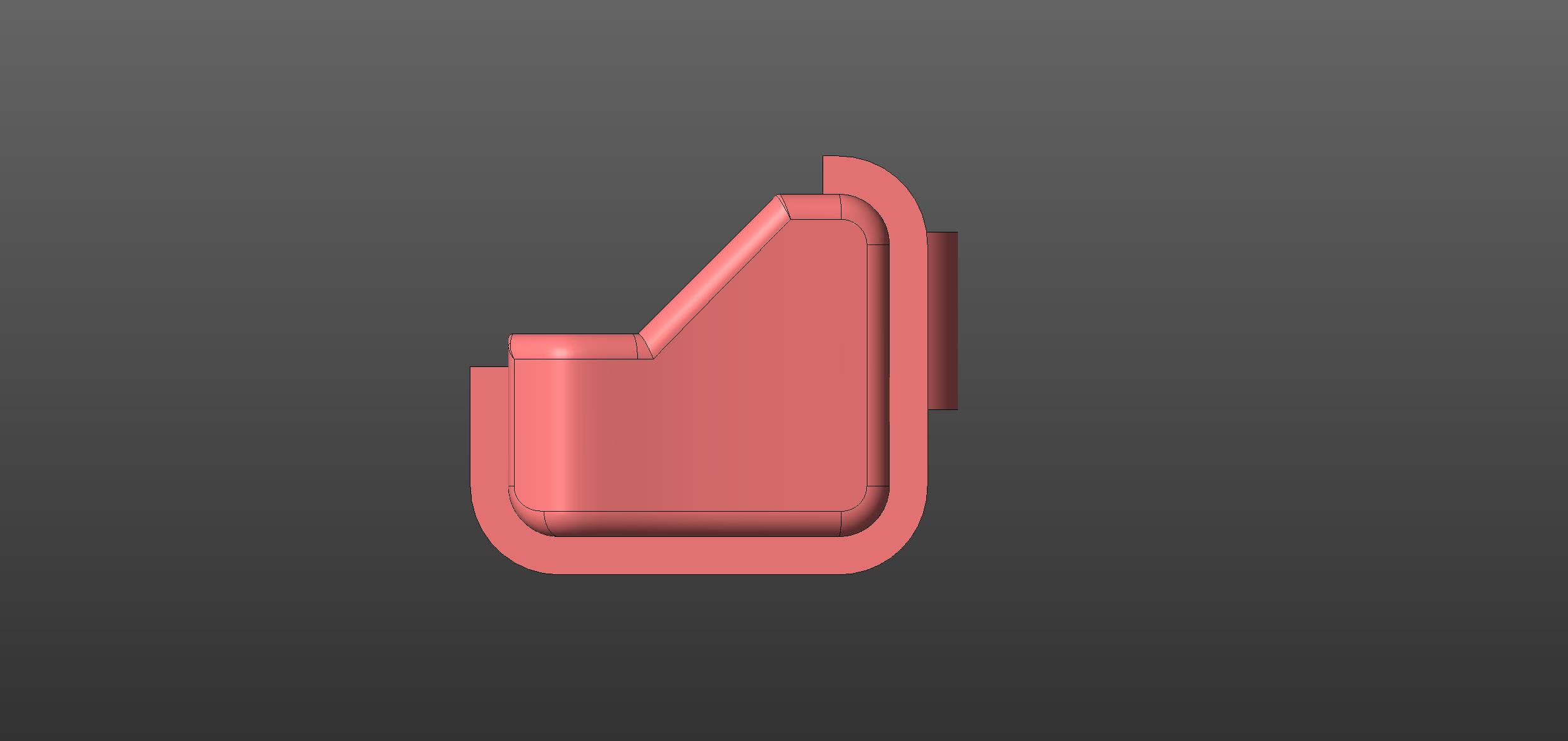

Have a nice week everybody. You did a great job with buttons,FA just had to take your idea and upgrade it for the buttons to work properly since they had mechanic experiance and how the mold will work.So i will create a new mold just for buttons (Free of charge ) .I tryed many ideas and deferend designs to make it work (aint easy to finish something that someone else started with the current space i have to work on ).Since the design is around the logic the first buttons are created what i have done is giving extra power to the button to move ouside with the plastic spring and fixing the outside of the button for better touch .Also with this idea having Button and spring together as one will help a lot with production not lossing time assample Pyra. PS: (this information i just sended to ED as i do here right now.Also dint finished yet since i wanna test it first about the touch,movement and matterial quality for the spring never to brake )

Thank you very much my friends. If there are people here who knows how to design i am open for ideas that has to do for the outside look of the button since dint create the mold yet.If the mold is created will be hard to change it so i wanna do good job from the start and now is the time.This days we need complete that and start creating the mold as soon as ED likes it too :) .

Methinks the looks are somewhat less important than how it feels to use them, and I think you're in the best position to test that. My first thought is that it looks like it sticks out a lot further than the other button (in its current incarnation) and I'm wondering how it feels to switch from one to the other or press both at the same time if need be. If you're planning to redesign the other button as well though perhaps it's too soon to say.

Is the shape the same as the old button? Or does the case need a redesign too?

I am looking forward for both ,Fuctional and aesthetics. Thats why i mansion "fixing the outside of the button for better touch " .Well i am doin what is best and the deferend perseption from other people helps alot bringing ideas to life. I am moving forward with it ,just had to mansion that if there is someone who designs inside here and have deferend perseption for the Outside look can talk freely cause the clock ticking and almost done with the changes of the buttons.Ideas will help improve what we are doin allready but if the mold been created will be hard to change it after .Priority is the Buttons to work properly,smooth movement and good touch of the fingers ,Aesthetic is the last part of it.

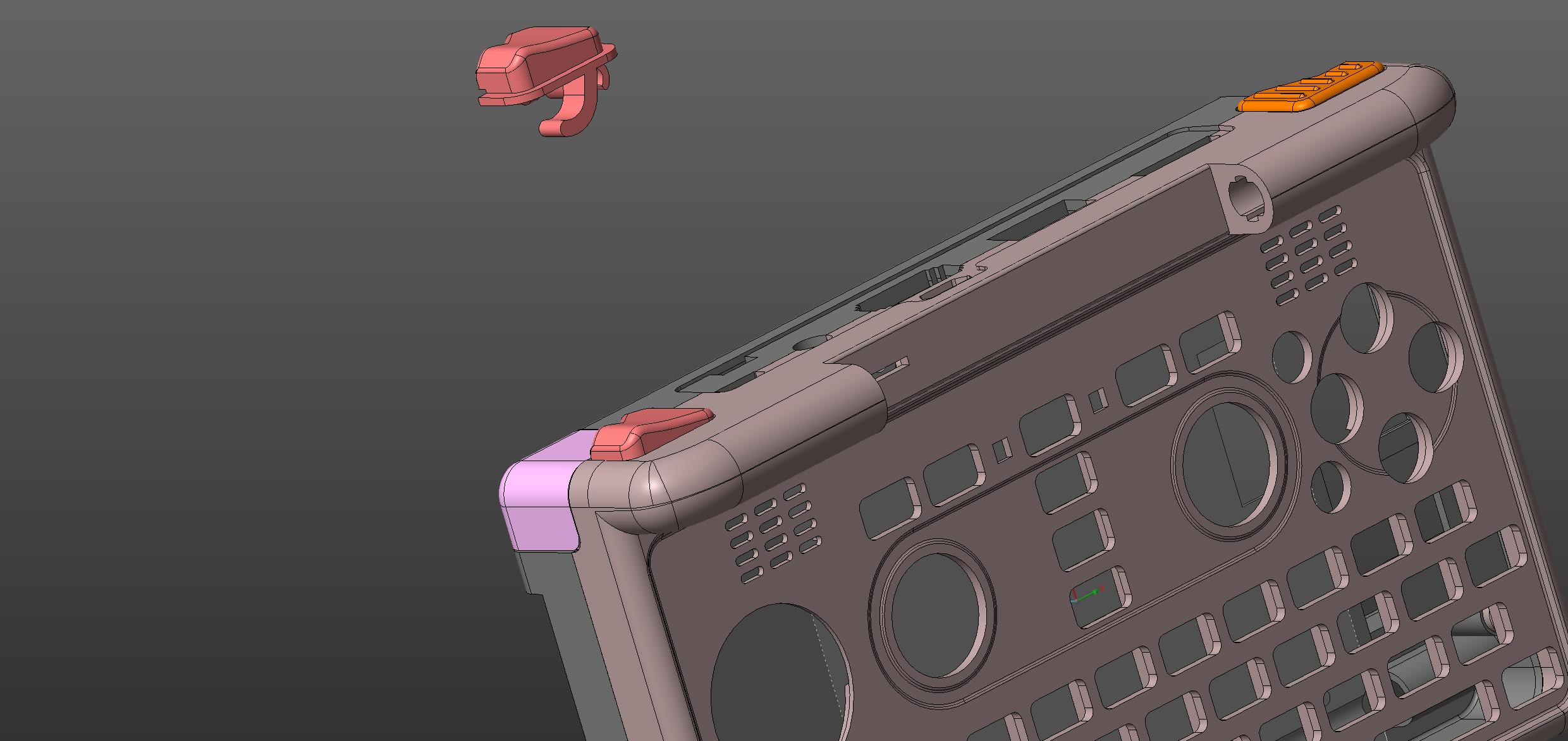

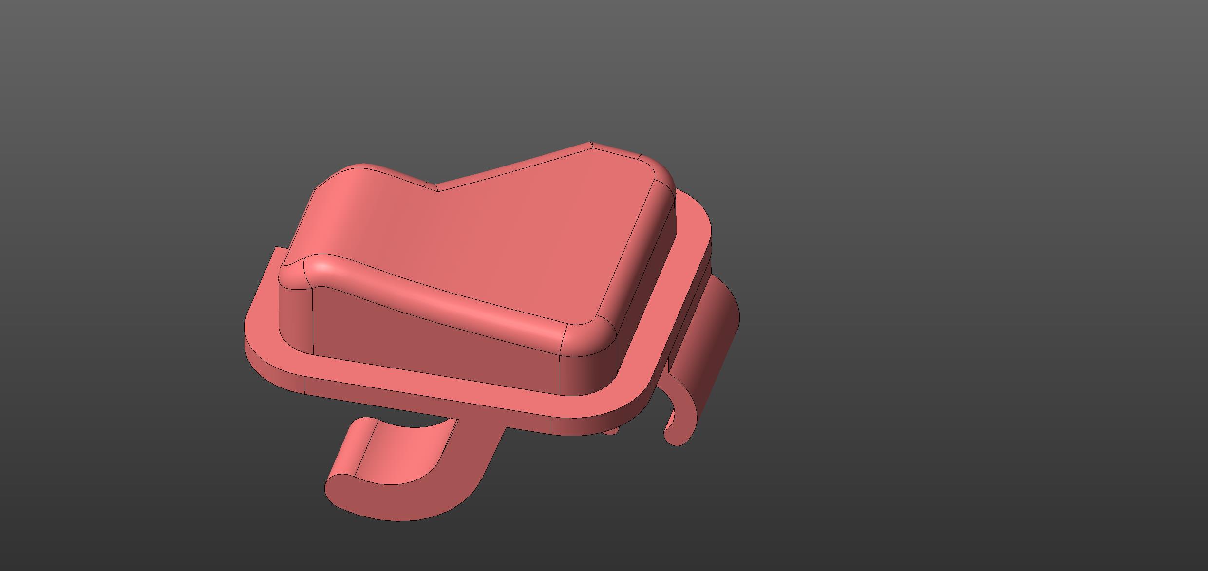

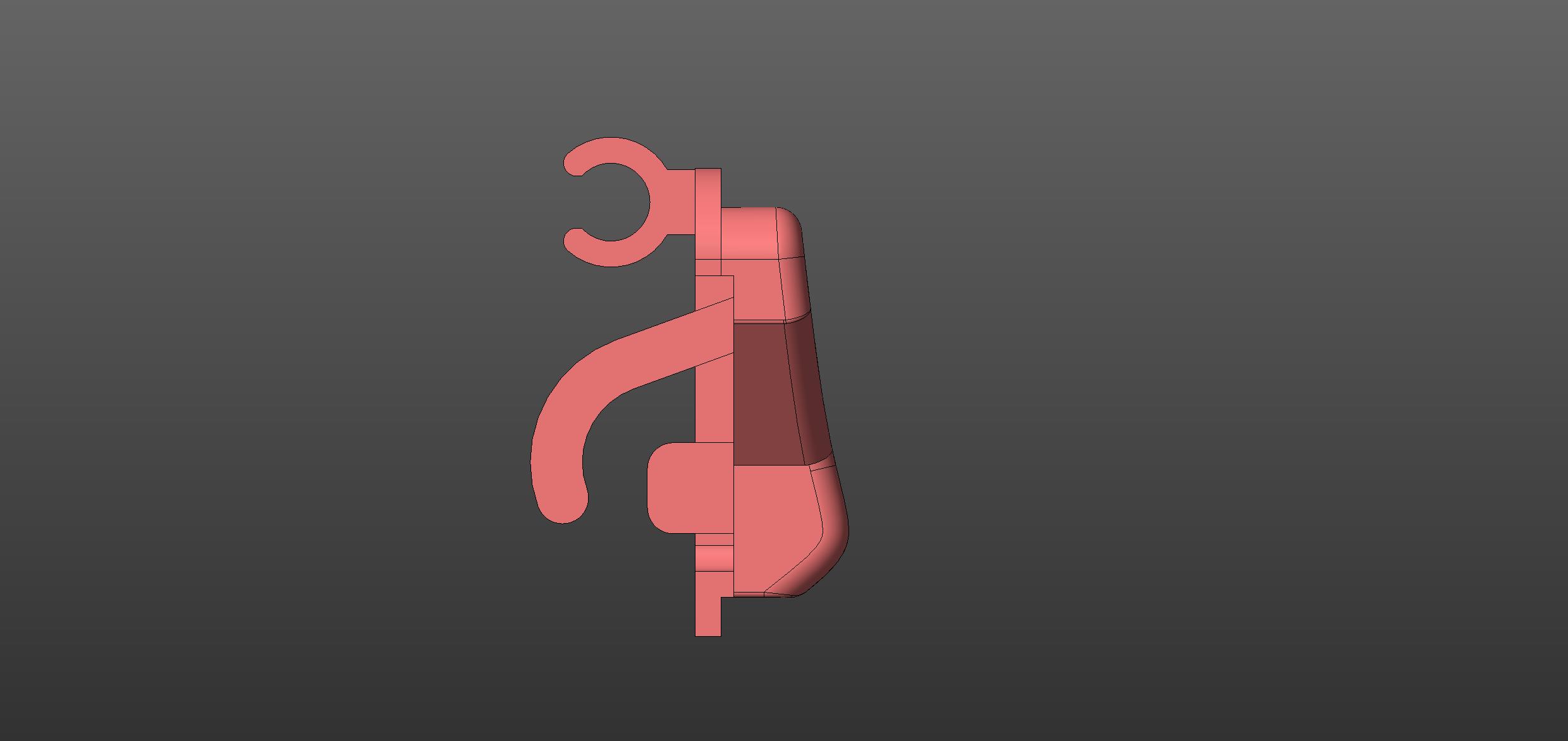

Interesting design. Could you change the perspective of the render so we can see the surface of the shoulder buttons a bit better?
From the pictures It looks a bit like a joystick fire button rather than a typical controller trigger (which would perfectly fine, especially as I grew up with c64 and quickshot/quickjoy joysticks)
there you go my friend :)
huge kudos for this awesome redesign azouls, verry good job! :cool:
i think neelix has a point here for making sure that the height-difference between the two shoulder-buttons is not too big.
if it is, it may be problematic to alternate between the two buttons fastly. a more flush side by side could avoid this potential issue.
but maybe it's just looking to stick out more in the large screencap. as you are actively working on it and have huge knowledge how it should feel, it will be cool, i'm sure, but it's always better to mention a potential issue *before* production. :D

Would the other button benefit from an inbuilt spring as well? It would need to be different, but a tongue leading back from it to lever back against the case back edge might be possible?
It may be possible but that will need redesign and creation of new moulds for other button too. That will add to the cost without giving additional advantages.

I'm not sure about a plastic "spring", these buttons should be as durable and sturdy as possible. Also, could make the molds more complex but I guess you know whats possible and whats not. I would still feel better with an metal (leaf)spring if a spring is really needed.
