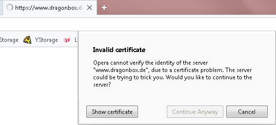

    Can someone who has SSL issues with the site check out www.dragonbox.de?
    It's using the same certication... does that work?
  5. xnopasaranx
    xnopasaranx Superbad!
    Joined:
    Jan 31, 2006
    Messages:
    3,121
    yeah I am getting the same error on dragonbox.de :(
    EDIT: okay, your server host is hetzner correct? I am actually getting the same SSL error when I try to open their company homepage (noticed because I am server shopping atm)

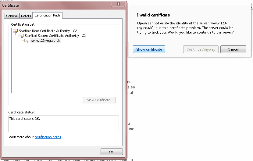

    Hmm I was checking out another site and I got this today, hmmmmm.

    Turns out I might only be getting cert errors because I have windows updates turned off, ah R.I.P
    --- Double Post Merged, Feb 12, 2018 ---
    I found a solution if you're on Windows 7, the Windows Updates doesn't fix anything so open regedit.exe, go to:
    Code:
    HKEY_LOCAL_MACHINE\SOFTWARE\Microsoft\SystemCertificates\AuthRoot
    And give this KEY full access permissions to this account:
    Code:
    NETWORK SERVICE
    Just for safe measure I did the same to
    "HKEY_LOCAL_MACHINE\SOFTWARE\Microsoft\SystemCertificates" aswell.
    Now Win7 will be able to auto-download verified root certificates like it's supposed to, hooray!
    Although for the mobile errors people here are having, I thought I'd see what happens if I try to load this site on my Blackberry Q10 and, it loaded up just fine with no SSL errors.
    It's a shame I have to do this on all my Windows 7 machines though, but it also fixed the other sites that had similar issues I mentioned.
