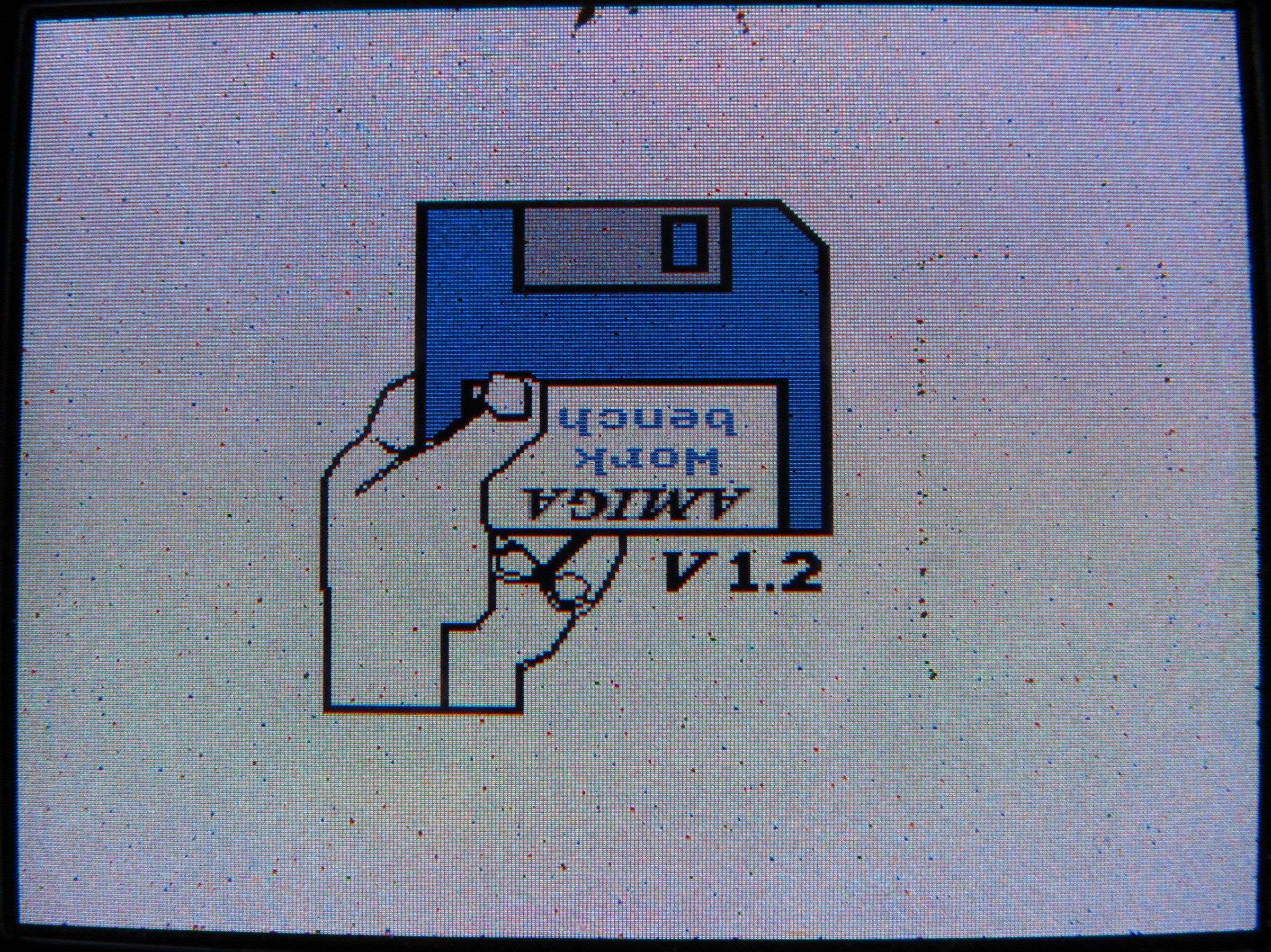

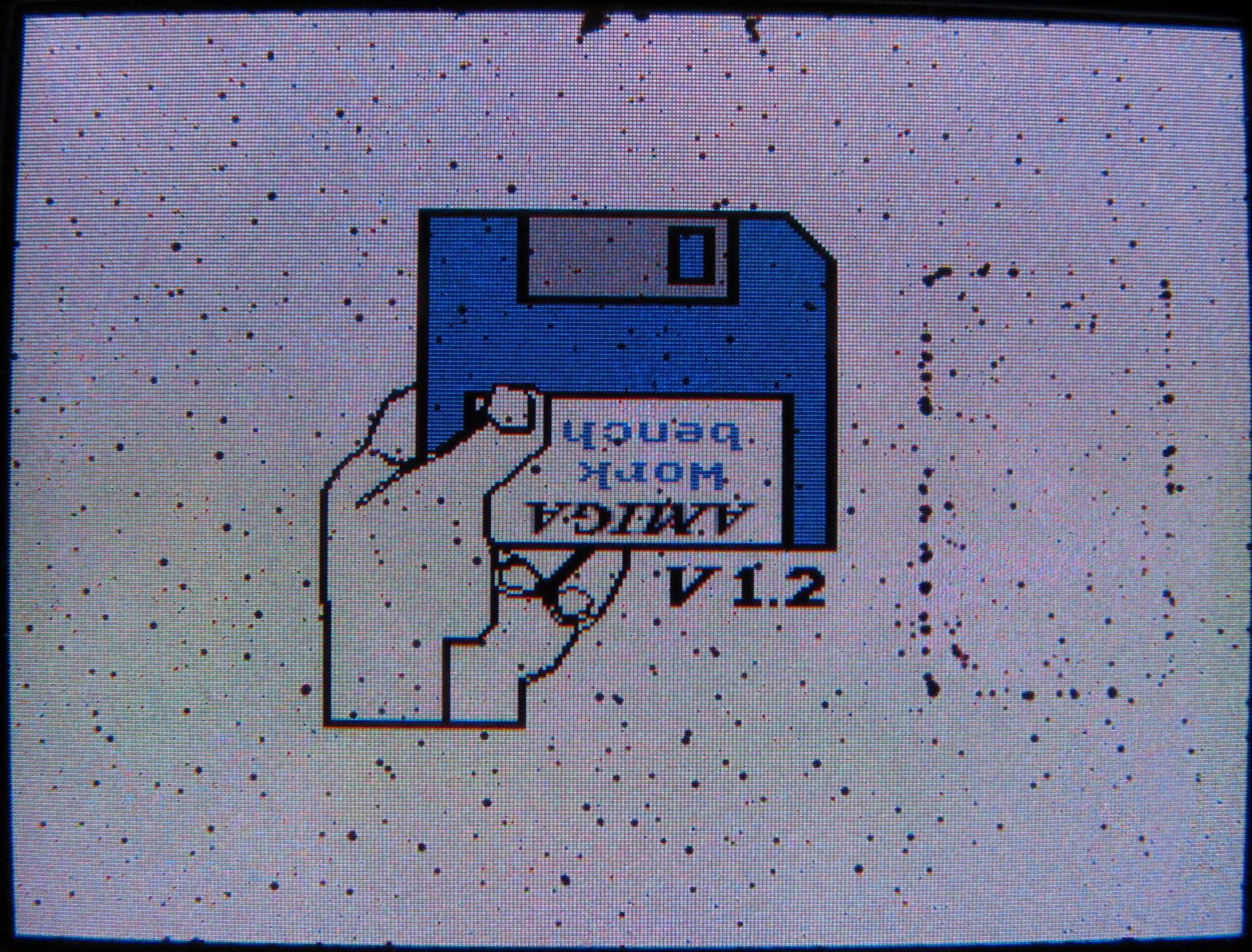

This happened to me a few days ago, i didn't know there where more people with the same problem.
A couple of images of how my screen is diyng day by day.
First notice:
Yesterday, after 3 days:
@ K-teto, thanks for the pics, those before and after shots are the best demonstration of pixel plague.

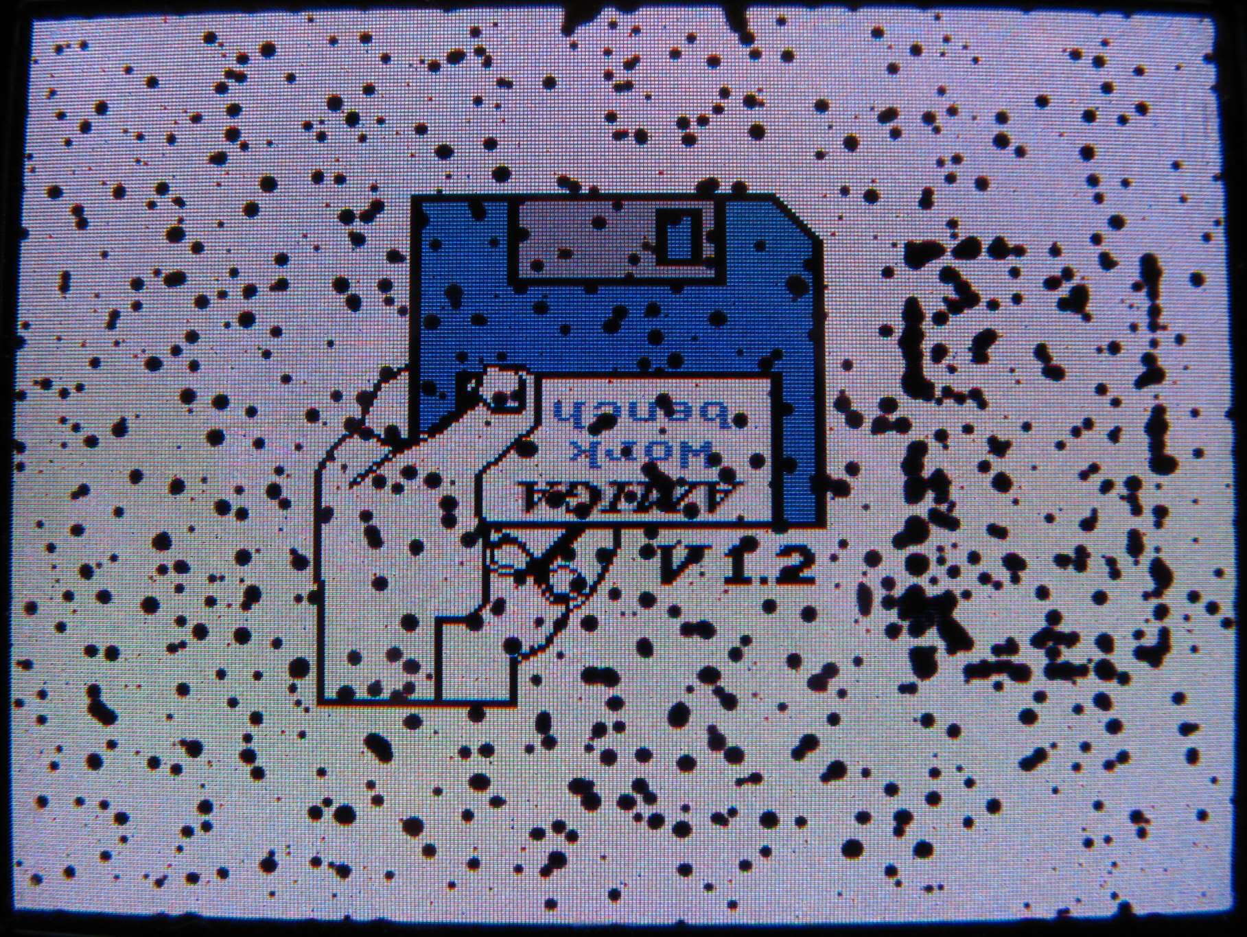

Well... the last photo before sending it for a replacement one, with the previous two, for comparison.
As you can deduce... it's at a point where anything is unplayable.
