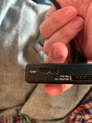

This long Connector where this cable also fits?

It will burn, laughing like a maniac, taking everone with it to the realm beyond.Cool, what would happen if I use this longer USB 3 Micro to USB A Cable for charging?
