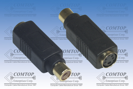

Can I ask what cables you're using? Cause my tv doesn't have an S-Video input either :(

What does an S-Video input look like?
Little round black input with holes for four pins.

you just need a small converter to turn your s-video into the standard video output "phono type" plug - theyre really easy to come by and dirt cheap. the if your tv has a scart socket you just get another scart to video audio converters whaich, again, are dirt cheap and on sale at any TV sales outlet...

The black end with the 4 round pins and 1 square pin is S-Video. The other end is RCA/Composite. That's an adapter, naturally. If you can hook it up with S-Video-- do so! The chroma and luma lines provide better color and brightness accuracy than just composite video does.
I tried using a converter like the one you mentioned but it gave me a black and white picture...
Could have just been a knackered component mind you.
I'd have to ask, cause I notice you're also from scotland, if your tv can handle NTSC format? Cause european tv's that dont will go black and white with that signal.... eh depends what you're trying to show on it I guess though... I wonder if the gp2x defaults a kinda NTSC output... oh I dont know, think I'm out of my depth here.
Yeah my tv can handle NTSC ok. I've tried switching between PAL and NTSC output just in case, but it didn't have any effect.
