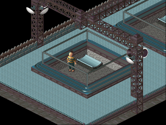

Here is Twin-E, en Engine to run Little Big Adventure
This version of the engin is the result of the merge of Preqengine and Twinengine.
