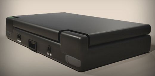

Theres also a couple of renders showing DC in, eg:
I'd really like some confirmation on this from a source that actually is in the know. I very much do not want to have to charge a 4000mAh battery through a USB socket.
EDIT: The Pandora wiki has the answer. Right at the bottom it says: "Can charge through AC adpater or USB". Phew!
I don't see myself using that USB option though. Like, not ever.
I would only if I had the charger in my room and I had a USB cord at my computer to charge it with and I would not be using it any time soon. Otherwise, I will do what Karel Jansens would do.
Odd that I never noticed the "DC in" jack on that render. I usually have a good eye for little details like that. The fact that on none of the spec sheets says anything about the polarity, voltage, or amperage of said jack led me to believe that there wasn't one at all.
Sorry for the misinformation.
