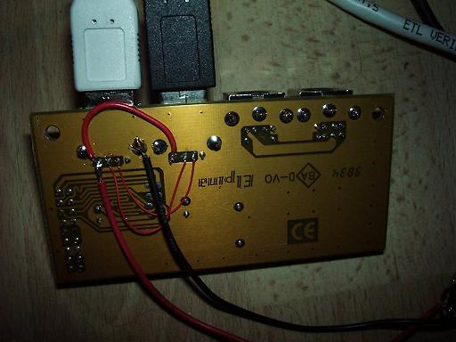

what is this thing you used to power the ethernet adapter, sure its selfmade.. could you make a tut for building this thing...
yeah sonic...its a two usb port for pc! Right toholl! I would like to know how did you transforme it in a usb hub with 5 V. I already own an asus one of that thing...so ho to 5v it? Please make a tut
It is not a hub. It is a passive 2 connectors card from an old pc box.
I just used the 2 usb connectors where I added wires to cross the signals and to add the 5v.
Ok, I will give you a picture in 10 minutes.
I just used the connector and add 5v on big red and black wires.
Ingeras said he didn't use this piece of hardware, his USB hub was ok on its own... I have a USB2 hub and I can use it without plugging it to a power source...
It should work as is as well
PS: the correct URL is http://jlefranc.free.fr/usb_alim.JPG (mind the caps)
