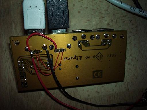

Usb Working !!!! On Gp32linux :)
well, i will make me this tomorrow and hope that the 9v battery can provide enugh power
would this wiring be able to be done inside the gp32 and just have a powered USB female port in the units body?
wherre would the 9v be attached?
and this wont mess up my ability to send files over the usb from my comp?
~Octavious
no, i dont think it will fit inside the gp, i would use 2xfemale usb plug so you can plug in your normal usb gp cable without destroying it and put the device in the other port. for the 9v i would use either a standart 9v batetry or 6 normal batterys if the 9v batetry will not give enugh ma.
maybe you can also use 4 normal rechargeables(4,8v) without any voltage converter, someone have to try.

toholl posted on Sep 2 2004 at 11:32 PM said:
I just used the connector and add 5v on big red and black wires.
thanks for the photo! i will make one that night!
damn, I just went to our local electronics store (the only one around, stupid wankers, overpriced etc.), and guess what: THEY DIDN`T HAVE A MALE TO MALE ADAPTER
Question is this an A Adapter, or an B Adapter? I found a german based site that sells those things for 45cent (eurocent that is), but the have like six different adapters (and all have the same pic)
