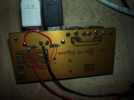

toholl posted on Sep 2 2004 at 11:32 PM said:
I just used the connector and add 5v on big red and black wires.
hey....ive done all the links...(ive just bought my first soldering...not bad for my first time!)...but the big red and black wires...where they go? To a 5v battery or charger? Whats the positive and the negative between the 2 wires? Thanks toholl
Power supply is done by a 5V REGULATED adaptor.
Big wires are connected to a female jack (you can see it at the down-right corner of the photo). The adaptor is connected to this female jack.
In electronic, there is a universal law:
- big RED wire: positive power supply (here 5V)
- big BLACK wire: ground (or 0V)
ok, thanks!!!....but the black one? Excuse me fro my ignorance!
All the big yellow surface you see on the card is the GROUND (0V) layer. I connected the black wire (power supply GROUND) to this layer, which is also connected to pin 4 (usb ground) of both usb connectors.
