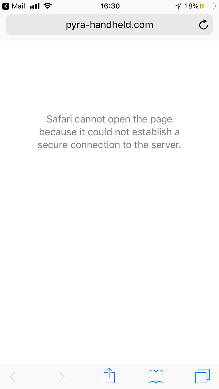

@Phlyra , that's because It's not a part of the forums... It's a true old school mailing list... Not sure if it's because of the firewall at work or it's actually broken, but this is typically the link to sign up for it.
Right! Obviously I have lots to learn! Thanks for the link, although after what you said I thought it must be broken (see attached screenshot)...until reading @theredbaron’s reply so now I’m a bit confused as to why it’s not working on my phone :S
Then emails from the list are still outputting the old URL in the signature.
I know... that's an issue with Webmin / VirtualMin (which I use for administration).
It handles MailMan and uses the domain names - but it's own port. And the certificate from that port is from rhea.dragonbox.de
No real idea how to fix that.
