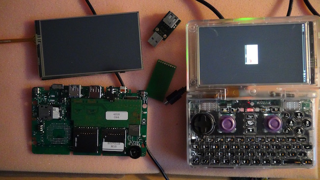

    I'm still concerned at how close the bottom of the dpad and the X button are to the keyboard keys. I have large thumbs, I can see myself accidentally hitting a key when going for d-pad down or the X button.
    I know ED said this was a real issue when doing early tests and was looking to address the issue. I think ED said he was adjusting the height of the keys/ buttons to address it. I'm wondering if there still is an issue there?

    Somewhat outdated Gamescom 2016 experience here, but it was essentially a non-issue for me. I think the action buttons stopped at a height before you'd even push down keyboard keys.
