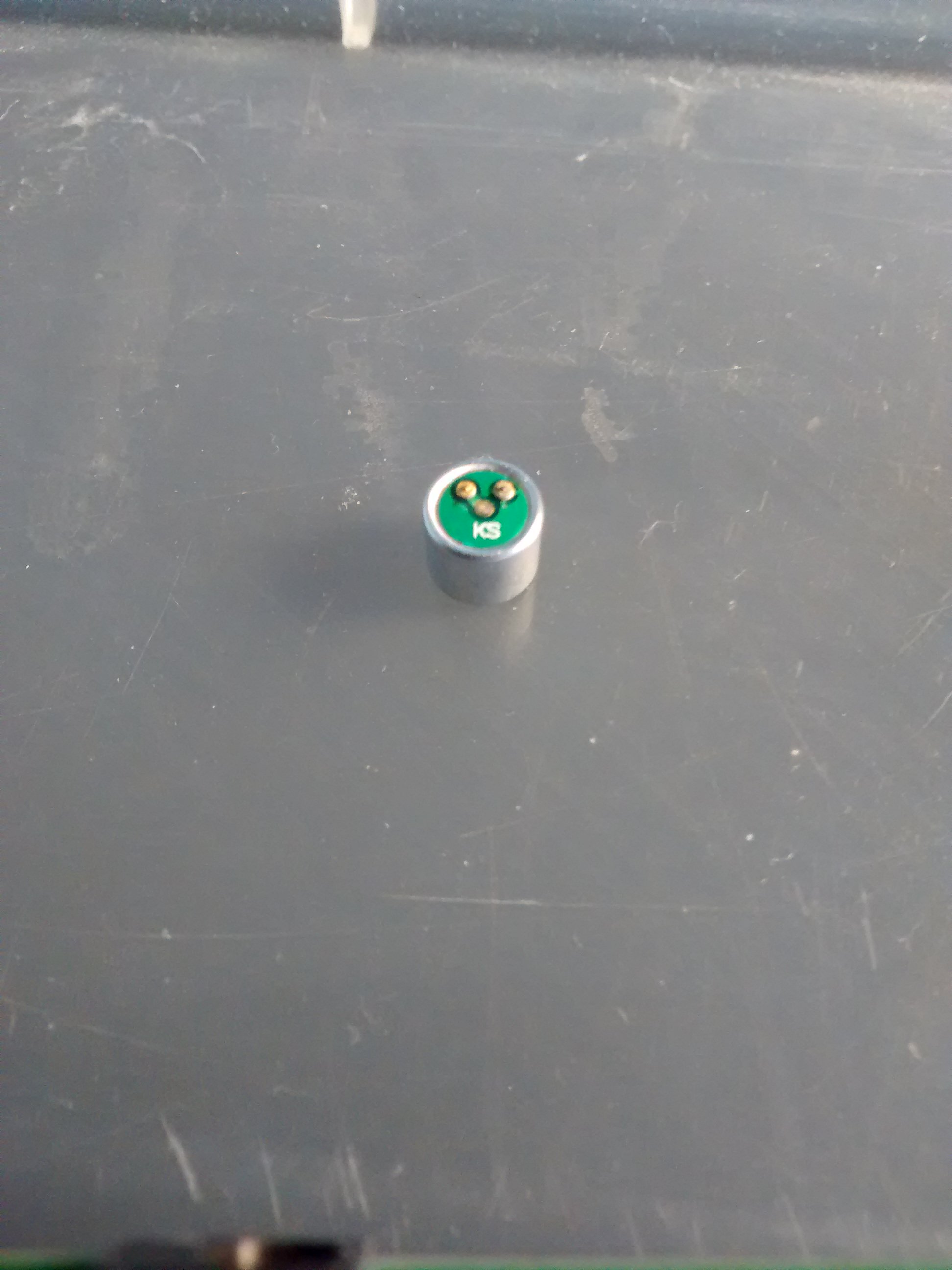

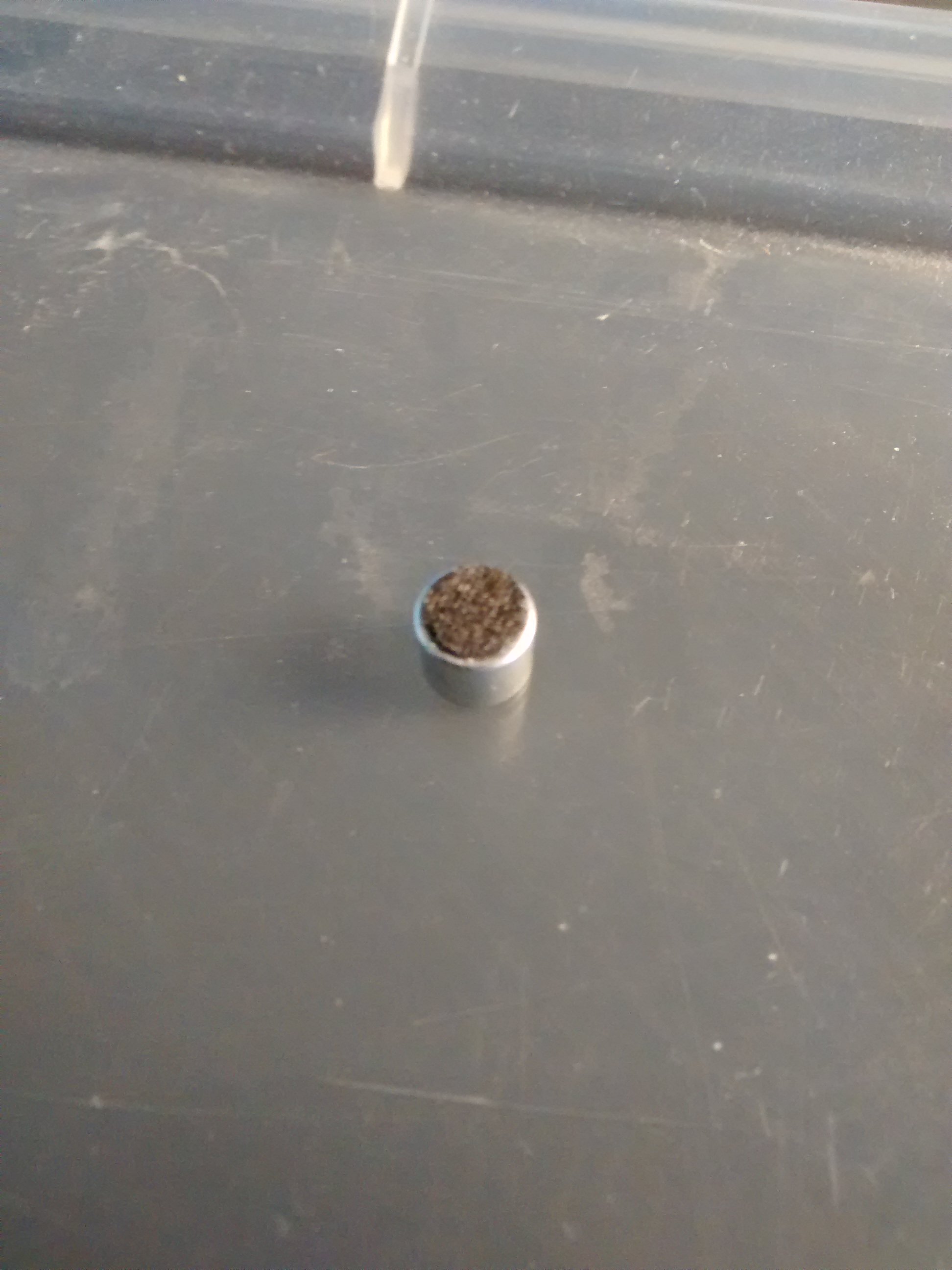

Hi All
I was in process of opening up Pandora to change old black case to a silver case and i stumbled at first hurdle!
a component dropped out and i have no idea where it dropped from. I have looked at the pcb pictures but cannot see it.
i attach photos of it, any help appreciated!
thx
peelie

It's the microphone 'CMC-5042PF-AC':
I think it's usually mounted on the front side of the PCB above the 0-key (top right), left from LEDs.

thanks for the component model!
if i ever feel like opening pandora again now know what to order to replace the fallen out microphone.
good news is that rest of cover change went well.
