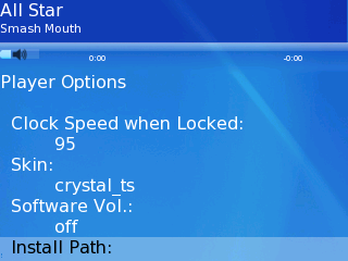

I tracked the flickering problem: It's only flickering when you choose a character via touchscreen or the buttons for a few seconds. It's pretty good when you don't do anything. Could it be the little picture on the left top displaying the chosen key? And yes this problem occurs with all virtual keyboards.
It's this screen I mean where you can also see some flicker. This flicker is steady even if you do nothing.
The most flicker is on the highlighted bar. In this case "Install Path".

Any difference in flicker on the settings page with the SWSURFACE build?
I believe you see the flicker on the keyboard and the settings page because the screen is actually redrawn often at those times. Most of the time, we don't actually re-draw anything unless something has changed and needs refreshed. I think the main culprit is going to be the slow 20fps I refresh at so as not to use alot of cpu with the UI. I'll research some of the other wiz flicker threads and then probably put together a couple of builds that refresh at a different rate, just to see if it makes any difference...
Nope.
I tried to fiddle a little bit with notaz display timing tool but no success..
Nope.
Another test build, defaults to 10fps. Accepts a new config file item "fps=??" to be manually added to the ommpc.conf file. So sometime you're feeling bored, you can try different values to see if it helps/hurts the flicker any...
Fiddled around with this, but no change at all. The performance isn't affected either. No matter if a choose 1 or 120fps.
I load the batteries of my camera and try to upload a little movie so you can get a better idea of the problem...
I'm going to attach another file that outputs the target fps because there should have been a definite noticable difference in the fps. 1fps should have been unusable with massive delay between button presses. You probably wouldn't notice much at the higher fps, but some things like the display current key in the top corner on the keyboard screen should disappear quickly as that isn't framerate limited in any way...
Also, found issues in my handling of the utf-8 file. The non-ASCII characters aren't showing up correctly...which kind of defeats the purpose of it being a utf-8 file.
One more thing, in regard to "Detach Client", can you check the output and see if it exits cleanly. I'm thinking it does, but something funny is going on when it tries to reload the menu while music is playing...
Detach client without muic playing:
Code:
Keyboard=32768state=1, keysym->sym=0End status polling thread
End art-loading thread
Exited cleanly
view created...
GP2X wiz Mode...
FB_OpenMouse()
Using tslib touchscreen
Check joystick...MES_MLC_SetLayerPriority.829: MES_ASSERT error
Detach client with music playing:
Code:
HYUN_DEBUG: pollux_audio_open()
Exited cleanly
view created...
GP2X wiz Mode...
FB_OpenMouse()
root@wiz:/usr/gp2x#
You're right: The Wiz don't crash, it's the menu. I can still control the Wiz via RS232. I call the menu. I hear some music and the menu crashes again.
Here's a complete log successfully starting and closing Ommpc:
Code:
EXIT
lang us-en
There is a byte order mark at the beginning of the file
child exit status 0
lang us-en
FB_OpenMouse()
1 joysticks were found.
    PEP Joy
set video mode
Unable to load button image: Couldn't open skins/crystal_ts/rnd_back.png
Unable to load button image: Couldn't open skins/crystal_ts/rpt_back.png
Unable to load button image: Couldn't open skins/crystal_ts/seek_big_back.png
target fps=57
away we go
updating db 0
np 0
Can't find
no art found, loading default
Exited cleanly
view created...
GP2X wiz Mode...
FB_OpenMouse()
audio_set_fragments
So the fps parameter is loaded. Can't see any change with flickering/performance yet, but will do some more testing.
My German translation can now be seen in the main menu at the bottom of the icons. But you're right utf-8 is messed up.
[Edit:] The fps parameter work! I tried values from 1- 120 and you now see a change in performance and flicker.
Testing now...
