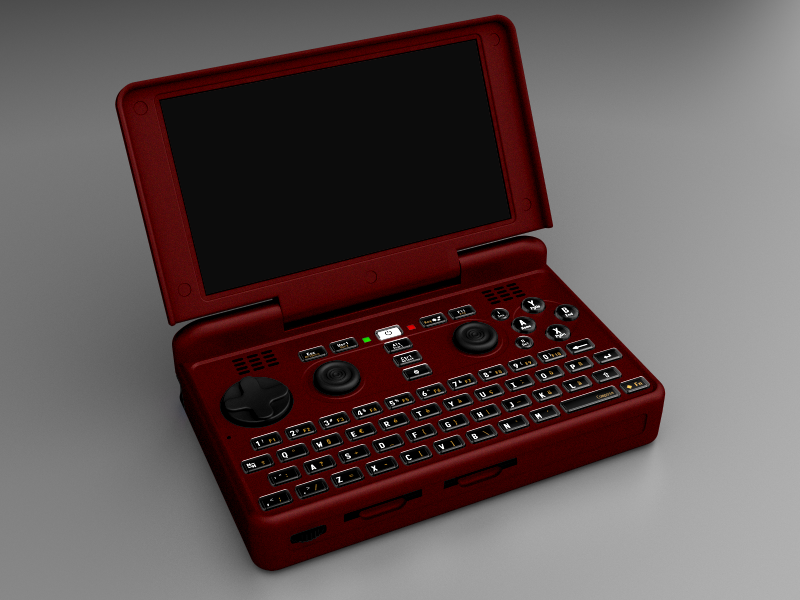

    But i do want pink for real.
    FaeMinx, SONY and WizardStan like this.
  20. levi
    levi Still fresh, damnit!
    Joined:
    Oct 6, 2008
    Messages:
    10,412
    Location:
    You mean like this?: [​IMG]
    Linked from the thread with all of the colours.
