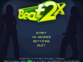

Beat2X is a StepMania-like rhythm game created by Miq01 and with Artwork by Zenzuke.
I have made a quick port and it works ok.
UPDATE: Please redownload. I have updated (archive is pending approval) the downloads with a 0.5.1 version that fixes the directory creation issue people were having. It also adds things like Esc button to quit immediately and other minor tweaks.
Some more improvements will come in the future... for now, enjoy!
Just a note on a couple of things...
-Keys 1 and 2 are the software volume control... we don't really need it on Pandora, but it's there should you feel like using it.
-A Scale2x filter is applied in order to get a 640x480 display from the original GP2X data files.
-Finally please make sure you read the documentation carefully and setup all the folders!
