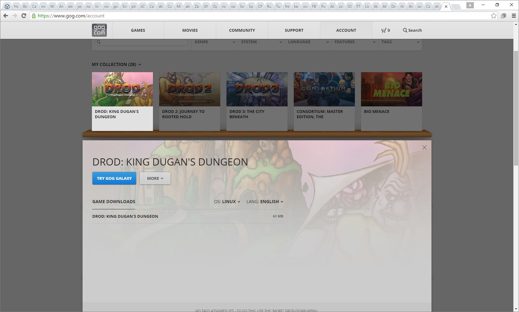

Thanks Seb i just bought the GOG version and it works after i installed on my PC and copied DATA folder on SD card like you said in first post.
The only thing different is i didn't find (for download) a linux version on GOG site...only a windows version (2.0.0.7), maybe because i used the old GOG downloader...i don't know for sure.
Anyway if you copy the folder after played this on PC, you copy also the settings (for the keyboard) of the PC, and on pandora the controls didn't work...so you may need to delete the player name and recreate one from zero...i did this and it worked.
