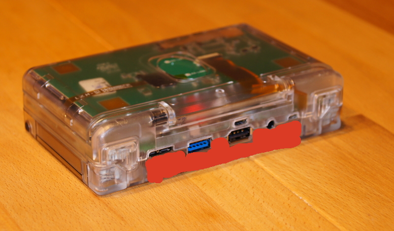

I have a drill ready to go. I should make a list of all the stuff I want to try with my clear case. Is it time for me to start gathering supplies, like paint and DS hinge?

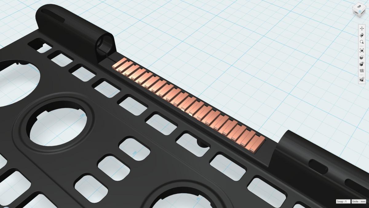

Possible, can't remember. I'm just surprised that there will be such a big copper heat spreader within the case. Goodthing for sure. I once designed a longer, thinner heatspreader that sits under the hinge area in the middle and is exposed to the outside.
Let me start with this: Having a CPU that can throttle is a GOOD thing.
Sure, except you need constant max speed without thermal throtteling. Mobile SoC's can't keep up for long when under load, but I want PC x86-like stamina when it comes to CPU speed! :D For idle/average usage, CPU throtteling is for sure very good, especialy on mobile devices to save battery power.
Yes it's likely. The copper block should be exposed to the outside.
Yes, would be more efficient I guess. The pins of that heat spreader could fit into holes in the case for example.

I can't remember if anyone else asked this: would fiberglass in the case plastic significantly impact the ability to dissipate heat?
Maybe we should just take out a speaker and put in a fan. Need to find a place to put the switch for the fan.
