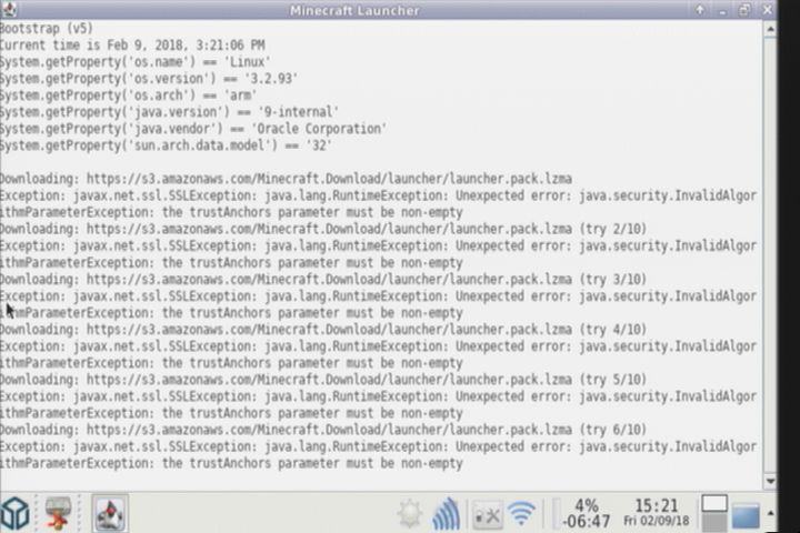

    The Java9 Versions do not download the Files:
    will try another Versions

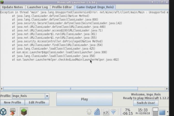

    unsupportet major Minor Version 52.0
    --- Double Post Merged, Feb 9, 2018, Original Post Date: Feb 9, 2018 ---
    it seem its the rescent MC Version.
    Seem to be not more Combatible with JDK7.

    Mmmm, java7 is deprecated :( so I guess they finaly removed Java7 support in Minecraft.
    I'll probably need to build a newer java9 sdk, but that's quite a pain. Need to debug this unsupported thingy with Java9.
    And there is no Java8 with Hotspot for armel (only for armhf).
    (both Java7 and Java9 should work with earlier version of minecraft)

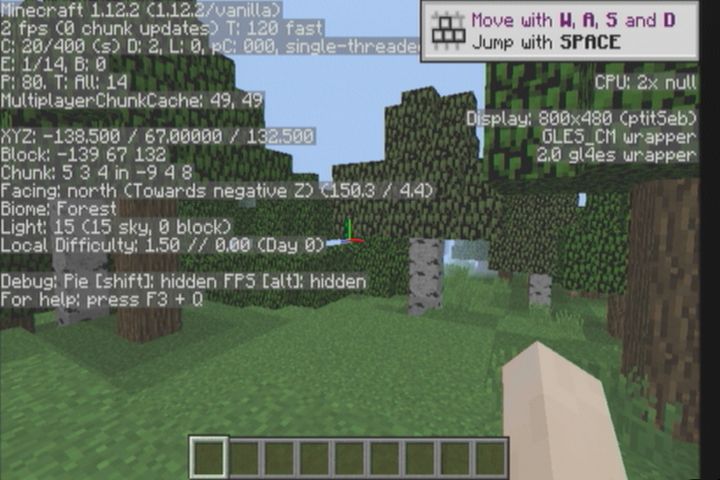

    EDIT:
    No visible Errors more with Enchantet Items.....yay :D
    EditEdit:
    with the Server "outside of the Pandora" it would be run as client very good.
    Have a Memory comsumption of around 240 MB only with lowest Settings

    thanks for the testing @ingoreis . Yeah OpenGL 2.0 with shaders ;)
    So, I have to find a fix for that error with Java9...

    So, I have updated both Java9 client and server package with an updated version. I also updated with latest gl4es. There are in the same link. Also, I removed debug info, so the packages are back to a more reasonable size.
    Both version seems to work now, not sure if I should push the client or the server version to the repo.
    Any feedback is welcome!
    (I have just noticed that OptiFine auto installation is broken... I'll work on that)
    --- Double Post Merged, Feb 10, 2018, Original Post Date: Feb 10, 2018 ---
    I have re-uploaded both client and server Java9 version (still same link).
    I have fixed the OptiFine auto-launch issue. Unfortunatly, current version of OptiFine doesn't seems to be compatible with Java9.
    I have also added some certificates, so it should download all stuff now.
    *EDIT* Also, I changed the default params, so you may want to remove appdata/minecraft/home/.params to get the new default (unless you already fined-tune it).

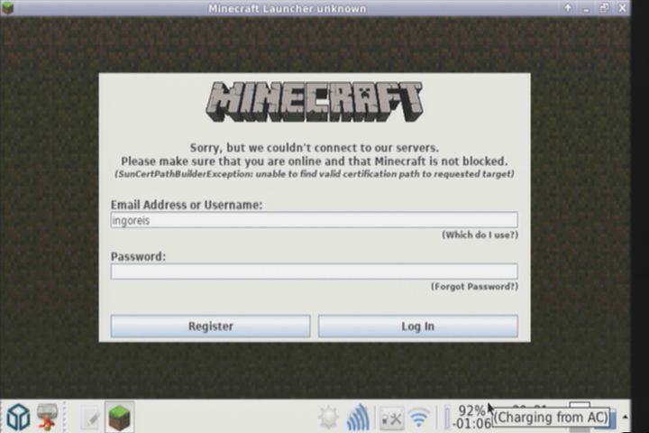

    Hi and sorry for little Bad News.
    Same Java Security Error woth both Java9 Versions.
    Tested both fixed Versions and they download the Files this Time but they let me not login onto my Account.
    here is the PND Runout with 3 Login Trys:

    [20:33:44 ERROR]: Unexpected exception refreshing version list
    javax.net.ssl.SSLHandshakeException: sun.security.validator.ValidatorException: PKIX path building failed: sun.security.provider.certpath.SunCertPathBuilderException: unable to find valid certification path to requested target
    at java.base/sun.security.ssl.Alerts.getSSLException(Alerts.java:198) ~[?:confused:]
    at java.base/sun.security.ssl.SSLSocketImpl.fatal(SSLSocketImpl.java:1962) ~[?:confused:]
    at java.base/sun.security.ssl.Handshaker.fatalSE(Handshaker.java:309) ~[?:confused:]
    at java.base/sun.security.ssl.Handshaker.fatalSE(Handshaker.java:303) ~[?:confused:]
    at java.base/sun.security.ssl.ClientHandshaker.checkServerCerts(ClientHandshaker.java:1843) ~[?:confused:]
    at java.base/sun.security.ssl.ClientHandshaker.certificateStatus(ClientHandshaker.java:1673) ~[?:confused:]
    at java.base/sun.security.ssl.ClientHandshaker.processMessage(ClientHandshaker.java:272) ~[?:confused:]
    at java.base/sun.security.ssl.Handshaker.processLoop(Handshaker.java:1061) ~[?:confused:]
    at java.base/sun.security.ssl.Handshaker.processRecord(Handshaker.java:995) ~[?:confused:]
    at java.base/sun.security.ssl.SSLSocketImpl.processInputRecord(SSLSocketImpl.java:1132) ~[?:confused:]
    at java.base/sun.security.ssl.SSLSocketImpl.readRecord(SSLSocketImpl.java:1069) ~[?:confused:]
    at java.base/sun.security.ssl.SSLSocketImpl.readRecord(SSLSocketImpl.java:968) ~[?:confused:]
    at java.base/sun.security.ssl.SSLSocketImpl.performInitialHandshake(SSLSocketImpl.java:1395) ~[?:confused:]
    at java.base/sun.security.ssl.SSLSocketImpl.startHandshake(SSLSocketImpl.java:1422) ~[?:confused:]
    at java.base/sun.security.ssl.SSLSocketImpl.startHandshake(SSLSocketImpl.java:1406) ~[?:confused:]
    at java.base/sun.net.www.protocol.https.HttpsClient.afterConnect(HttpsClient.java:558) ~[?:confused:]
    at java.base/sun.net.www.protocol.https.AbstractDelegateHttpsURLConnection.connect(AbstractDelegateHttpsURLConnection.java:185) ~[?:confused:]
    at java.base/sun.net.www.protocol.http.HttpURLConnection.getInputStream0(HttpURLConnection.java:1535) ~[?:confused:]
    at java.base/sun.net.www.protocol.http.HttpURLConnection.getInputStream(HttpURLConnection.java:1463) ~[?:confused:]
    at java.base/sun.net.www.protocol.https.HttpsURLConnectionImpl.getInputStream(HttpsURLConnectionImpl.java:235) ~[?:confused:]
    at com.mojang.launcher.Http.performGet(Http.java:54) ~[launcher.jar:confused:]

    [20:34:37 INFO]: Logging in with username & password
    [20:34:39 ERROR]: Couldn't log in
    com.mojang.authlib.exceptions.AuthenticationUnavailableException: Cannot contact authentication server
    at com.mojang.authlib.yggdrasil.YggdrasilAuthenticationService.makeRequest(YggdrasilAuthenticationService.java:71) ~[launcher.jar:confused:]
    at com.mojang.authlib.yggdrasil.YggdrasilUserAuthentication.logInWithPassword(YggdrasilUserAuthentication.java:74) ~[launcher.jar:confused:]
    at com.mojang.authlib.yggdrasil.YggdrasilUserAuthentication.logIn(YggdrasilUserAuthentication.java:57) ~[launcher.jar:confused:]
    at net.minecraft.launcher.ui.popups.login.LogInForm$4.run(LogInForm.java:171) [launcher.jar:confused:]
    at java.base/java.util.concurrent.ThreadPoolExecutor.runWorker(ThreadPoolExecutor.java:1161) [?:confused:]
    at java.base/java.util.concurrent.ThreadPoolExecutor$Worker.run(ThreadPoolExecutor.java:635) [?:confused:]
    at java.base/java.lang.Thread.run(Thread.java:844) [?:confused:]
    Caused by: javax.net.ssl.SSLHandshakeException: sun.security.validator.ValidatorException: PKIX path building failed: sun.security.provider.certpath.SunCertPathBuilderException: unable to find valid certification path to requested target
    at java.base/sun.net.www.protocol.http.HttpURLConnection.getOutputStream0(HttpURLConnection.java:1310) ~[?:confused:]
    at java.base/sun.net.www.protocol.http.HttpURLConnection.getOutputStream(HttpURLConnection.java:1285) ~[?:confused:]
    at java.base/sun.net.www.protocol.https.HttpsURLConnectionImpl.getOutputStream(HttpsURLConnectionImpl.java:231) ~[?:confused:]
    at com.mojang.authlib.HttpAuthenticationService.performPostRequest(HttpAuthenticationService.java:73) ~[launcher.jar:confused:]
    at com.mojang.authlib.yggdrasil.YggdrasilAuthenticationService.makeRequest(YggdrasilAuthenticationService.java:54) ~[launcher.jar:confused:]
    ... 6 more
    Caused by: sun.security.validator.ValidatorException: PKIX path building failed: sun.security.provider.certpath.SunCertPathBuilderException: unable to find valid certification path to requested target
    at java.base/sun.security.validator.PKIXValidator.doBuild(PKIXValidator.java:386) ~[?:confused:]
    at java.base/sun.security.validator.PKIXValidator.engineValidate(PKIXValidator.java:291) ~[?:confused:]
    at java.base/sun.security.validator.Validator.validate(Validator.java:264) ~[?:confused:]
    at java.base/sun.security.ssl.X509TrustManagerImpl.validate(X509TrustManagerImpl.java:343) ~[?:confused:]
    at java.base/sun.security.ssl.X509TrustManagerImpl.checkTrusted(X509TrustManagerImpl.java:237) ~[?:confused:]
    at java.base/sun.security.ssl.X509TrustManagerImpl.checkServerTrusted(X509TrustManagerImpl.java:124) ~[?:confused:]
    at java.base/sun.security.ssl.ClientHandshaker.checkServerCerts(ClientHandshaker.java:1822) ~[?:confused:]
    ... 6 more
    Caused by: sun.security.provider.certpath.SunCertPathBuilderException: unable to find valid certification path to requested target
    at java.base/sun.security.provider.certpath.SunCertPathBuilder.build(SunCertPathBuilder.java:141) ~[?:confused:]
    at java.base/sun.security.provider.certpath.SunCertPathBuilder.engineBuild(SunCertPathBuilder.java:126) ~[?:confused:]
    at java.base/java.security.cert.CertPathBuilder.build(CertPathBuilder.java:297) ~[?:confused:]
    at java.base/sun.security.validator.PKIXValidator.doBuild(PKIXValidator.java:381) ~[?:confused:]
    ... 6 more

  18. ptitSeb
    ptitSeb Serial Porter
    Joined:
    Aug 15, 2012
    Messages:
    7,811
    Location:
    France, near Lyon
    @ingoreis : so it's still missing a certificate. I need the certificate, or at least the adress where it tries to connect so I can try to get the certificate (use PaleMoon, connect to site and Export the certificate from here), so I can add the certificate to the cacerts of the new Java9 distrib...
    ingoreis likes this.
  19. ingoreis
    ingoreis Advanced Member
    Joined:
    Mar 7, 2012
    Messages:
    2,968
    Location:
    49.491276,8.423518
    And how can i figure out what for a Internet Site is contacted in that special Case?
  20. ptitSeb
    Joined:
    Aug 15, 2012
    Messages:
    7,811
    Location:
    France, near Lyon
    I don't know. There is nothing in the trace... some Wireshark may help, but that's not easy to do.
