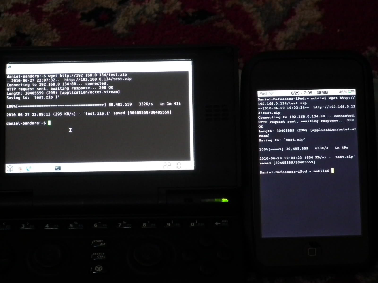

Of course, the best way to compare speed would be a raw tcp dump. Easy enough to do on the Pandora, don't think it's possible on the iPod, so we'll have to stick with as close a comparison as we can get: web page load times.
Just did a wget of the same file on a local server on both my Pandora and my first gen iPod touch-
Average of 295KB/s on the Pandora and 604KB/s on the iPod.
