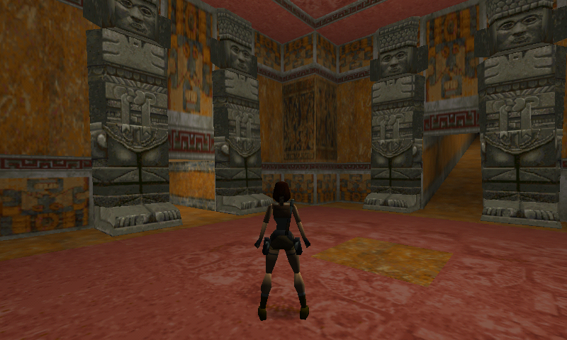

Here is OpenLara, an open source recreation of the Tomb Raider 1, 2 and 3 Engine.
(GLES2 version screenshot)
This build use GL4ES (there is GLES2 port, but not using Linux, so this was the faster way to port it). The audio backend is using OSS (again, that was the easier and faster way to port, even faster then ALSA). The default keymap has been slightly adapted to fit the Pandora.
You need to put the game data in appdata/openlara to play this.
You can either copy the "data" and "fmv" folder from CD (or CD image) directly or put individual data files inside "level/X" folder (X is either 1, 2 or 3). Look at the readme.txt inside each folder for detail.
Also, CD Rip audio goes in audio/X folder, with name track_XX.mp3 or track_XX.ogg

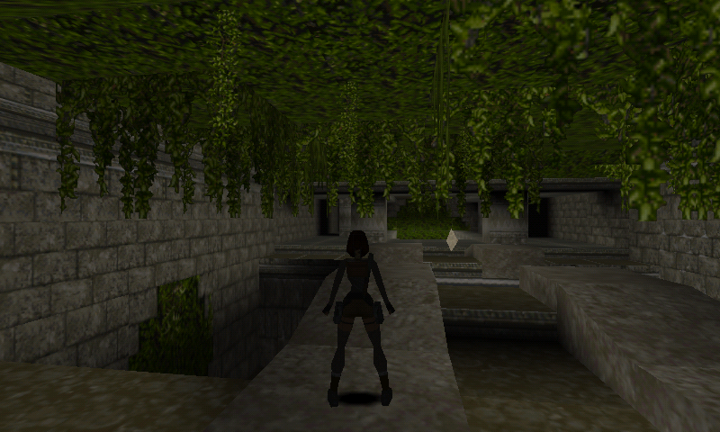

(GLES1 version screenshot)
Starting with build 03, there is 2 version of the engine in the PND: one for GLES1 and the other for GLES2. Depending on the Pandora model it's run on, it will automatically select GLES1 for CC model and GLES2 for the other. You can force a version by creating a file names ".es" (without quotes) inside appdata/openlara and puting either 1 or 2 to select the GLES version.
The GLES1 version is prety fast for video (faster then GLES2) but the game itself has worse lighting than GLES2 version.
The GLES2 game take some time to start (it build it's shader at every start), so be patient (I'll try implement Binary shaders in gl4es later, that should accelerate the starts). In options, you can put Lighting up to HIGH without issue. Shadows can be put to MEDIUM but there is a bit of slowdown there. Water shaders should be left to LOW, other settings slows down things too much (and doesn't seems to produce the correct visuals anyway).
I have tested only with Steam version of TR1 (data are inside GAME.GOG that is in fact an .bin image, with GAME.DAT beeing the .cue file, and I had to rename the mp3 tracks, adding "track_" in front).
Expect silent crash if the data are not in the correct places (or with correct name).

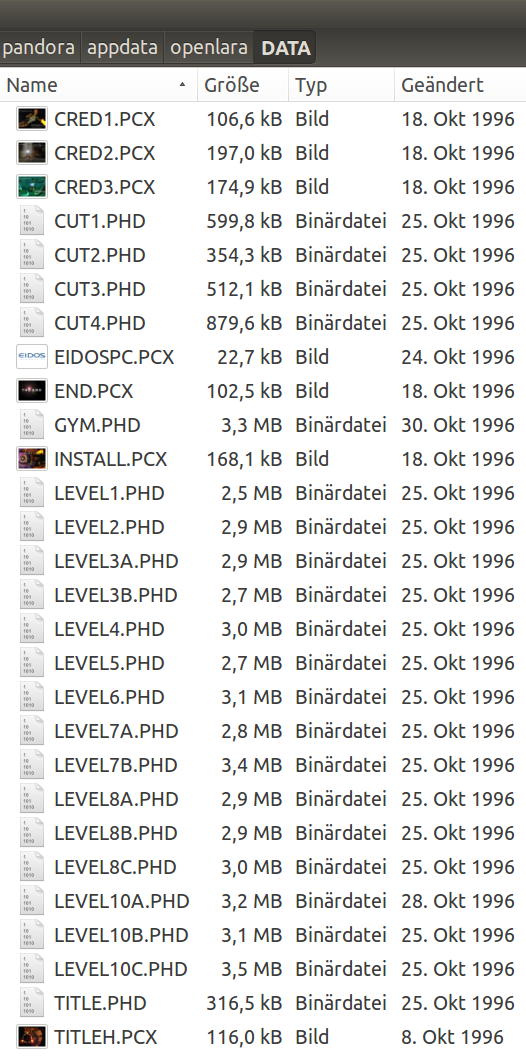

I tried to install it, but it wont start. Im using the game-files from Tomb Raider 1 Directors Cut. I put the data and fmv folder inside appdata/openlara.
Openlara starts, I see an empty window with the title-bar "openlara" and after a few seconds loading (led-flashing) it desapear.
I tried single-level-files too, but still no luck.
Could you help?

all looks good (but you should put the log inside spoiler tags) except this
Code:
error loading file "level/1/TITLE"
It looks like it doesn't find the datas.
Here is my appdata/openlara is (with TR1 datas extracted from ISO from the steam version)
Code:
ll /media/PANDOSEB/pandora/appdata/openlara/
total 64
drwxrwxrwx 2 root root 16384 Sep 30 22:29 DATA
drwxrwxrwx 2 root root 16384 Sep 30 22:29 FMV
drwxrwxrwx 3 root root 16384 Sep 30 22:31 home
-rwxrwxrwx 1 root root   207 Sep 30 22:28 openlara.txt
(don't mind the 777 mask, it's a FAT32 SDCard, but I have ran it also from a ext2).
and DATA looks like:
Code:
ll /media/PANDOSEB/pandora/appdata/openlara/DATA/
total 50624
-rwxrwxrwx 1 root root  106587 Sep 30 22:29 CRED1.PCX
-rwxrwxrwx 1 root root  196985 Sep 30 22:29 CRED2.PCX
-rwxrwxrwx 1 root root  174908 Sep 30 22:29 CRED3.PCX
-rwxrwxrwx 1 root root  599840 Sep 30 22:29 CUT1.PHD
-rwxrwxrwx 1 root root  354320 Sep 30 22:29 CUT2.PHD
-rwxrwxrwx 1 root root  512104 Sep 30 22:29 CUT3.PHD
-rwxrwxrwx 1 root root  879582 Sep 30 22:29 CUT4.PHD
-rwxrwxrwx 1 root root   22700 Sep 30 22:29 EIDOSPC.PCX
-rwxrwxrwx 1 root root  102512 Sep 30 22:29 END.PCX
-rwxrwxrwx 1 root root 3237128 Sep 30 22:29 GYM.PHD
-rwxrwxrwx 1 root root  168100 Sep 30 22:29 INSTALL.PCX
-rwxrwxrwx 1 root root 3224138 Sep 30 22:29 LEVEL10A.PHD
-rwxrwxrwx 1 root root 3094342 Sep 30 22:29 LEVEL10B.PHD
-rwxrwxrwx 1 root root 3532024 Sep 30 22:29 LEVEL10C.PHD
-rwxrwxrwx 1 root root 2533634 Sep 30 22:29 LEVEL1.PHD
-rwxrwxrwx 1 root root 2873450 Sep 30 22:29 LEVEL2.PHD
-rwxrwxrwx 1 root root 2934730 Sep 30 22:29 LEVEL3A.PHD
-rwxrwxrwx 1 root root 2738258 Sep 30 22:29 LEVEL3B.PHD
-rwxrwxrwx 1 root root 3030872 Sep 30 22:29 LEVEL4.PHD
-rwxrwxrwx 1 root root 2718540 Sep 30 22:29 LEVEL5.PHD
-rwxrwxrwx 1 root root 3074376 Sep 30 22:29 LEVEL6.PHD
-rwxrwxrwx 1 root root 2817612 Sep 30 22:29 LEVEL7A.PHD
-rwxrwxrwx 1 root root 3389096 Sep 30 22:29 LEVEL7B.PHD
-rwxrwxrwx 1 root root 2880564 Sep 30 22:29 LEVEL8A.PHD
-rwxrwxrwx 1 root root 2886756 Sep 30 22:29 LEVEL8B.PHD
-rwxrwxrwx 1 root root 3105450 Sep 30 22:29 LEVEL8C.PHD
-rwxrwxrwx 1 root root  115980 Sep 30 22:29 TITLEH.PCX
-rwxrwxrwx 1 root root  316460 Sep 30 22:29 TITLE.PHD

I installed the Build 02 but still wont start.
Here is the new logfile and a picture of the DATA-folder.

Fills seem to be in the corect places, and I don't see any trace of OpenLara complaining about a missing file. Strange it doesn't start.
For SGX, I used 4.10 driver (I also have a large swapfile, but I don't think that could make a change).
