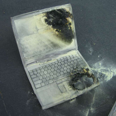

I want to run my Pandora at 900MHZ all the time and I want a full and covered warranty when I up the voltage until it melts..
HEY CAN I GO TO MY LOCAL TI AND GET A 900MHZ CHIP AND PUT IN PNADORA AND OVERCLOCK TO 1.7GHZ I SAW N900 THAT OUSLD BE SWEET!!!!
Mofokubik said:
And you are showing us damage caued by a blown-up LiPo battery because...? Scratch that, that's where the HDD usually is.
