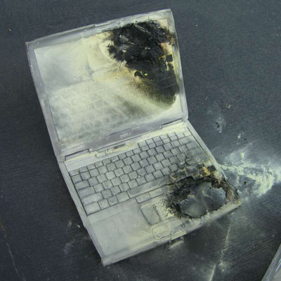

And you are showing us damage caued by a blown-up LiPo battery because...? Scratch that, that's where the HDD usually is.
That is where the battery is on those dell laptops
Hehe, still using one of those but with TWO battery packs (one at each side of the touchpad) :)
If both blow up i'll post a picture :)
If you/hands survive the incident, that is. :rolleyes:
Yoyobuae said:
He'll be fine silly, his hand will be BETWEEN the explosions.
