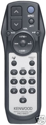

I was thinking maybe there's a blue tooth remote control because I was thinking of doing the same thing. actually let me look...
Yep there's quite a few on ebay, I'm guessing the ones for specific stereos should work fine? I think BT is pretty plug and play, isn't it?
Bluetooth! Of course. Those Kenwood remotes on ebay are cheap and plentiful.
I'll put that one on the backburner for now, but when the time comes it'll be a much better option than USB.
