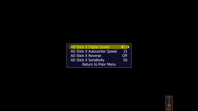

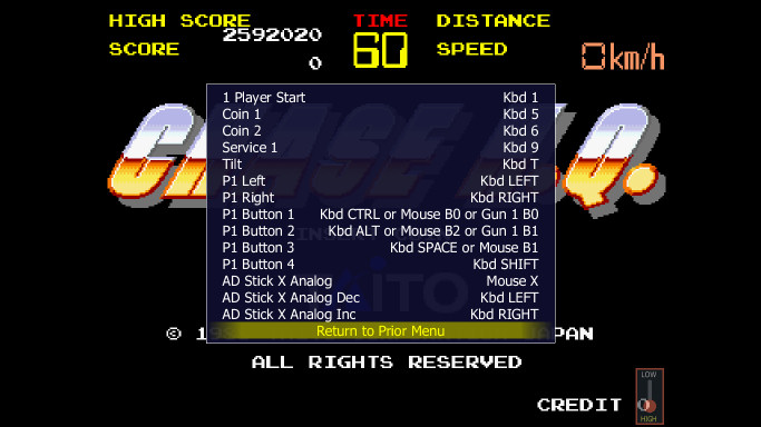

This is a screen grab from MAME .143
As you can see there is the option for using a mouse for the wheel, and the 2nd image lets you set the sensitivity.
Hmmm, I don't know if these options are in AdvanceMAME.
As said, a mouse won't work here, as notaz sdl doesn't support it, but for the joystickoptions, try to find a menu like this in our AdvanceMAME.
I think you would need to configure the nubs as analog instead of digital joysticks in the configfile.
If you figure it out, let us know. I have no time right now :)
Both these menu's are in AdvanceMAME, I just can't take screen-grabs.
The 1st menu is under Input (this game) but will only show analogue controls if the game supports them.
The 2nd menu is called Analog Controls.
