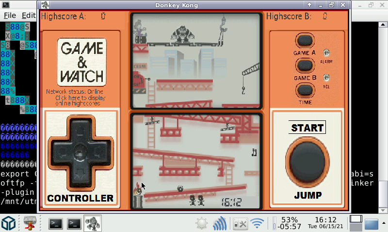

Thanks. Got the local version working now. It was Filezilla that messed up the x86 executables for me. Downloading them as zip files instead and the elf header error was gone.
It plays ok, but some sounds are missing. There are some very short sound samples in there that the sound system misses.
From your screenshot I see that you have got the online version working.
The hurl plugin require libssl1.0.0. My pandora have openssl version 0.9.8.zh-r1.5, so I guess I need to find a way to update it to 1.0.0

Yes, it was probably running the old box86t executable. I renamed the one in codeblocks/usr/bin to box86t_ and now the online version starts.
It runs and you can play the game. But as soon as it tries to go online, it will fail. It will try go go online as soon as you either click in the area "Click here to display highscores", or after finishing a game (will go online to check your score against the online highscore list).

Ah, yes, more symbol to wrap are needed. I'll add them and make a new build. I'll to play a bit to see if the upload of score works.
Ok @amyren I have updated box86 (at the same link) with a version were the upload of Hiscore works.
hm. the list was updated 3 days ago, so I see no update today.
You know you need to beat the scores to get to upload that list?;)
Anyway, excellent work. I just tested it and it does work, both downloading the list and uploading.
Managed to get on the Game B list, and entered playername Pand_box86 in tribute to the box86
