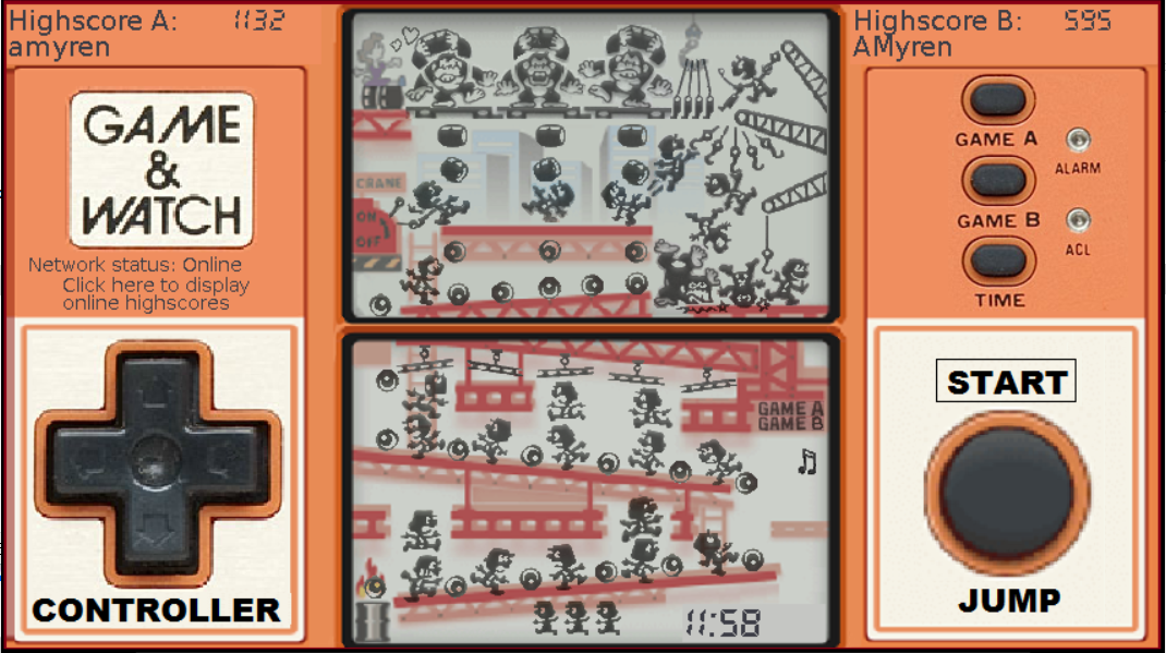

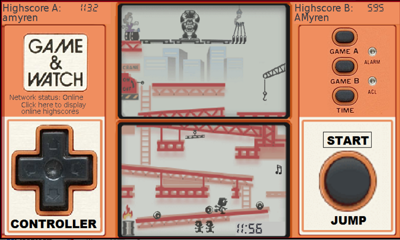

the xml and the runscript files are attached, as well as the png´s
