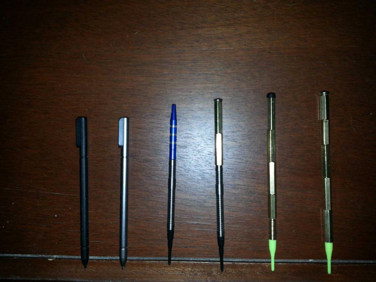

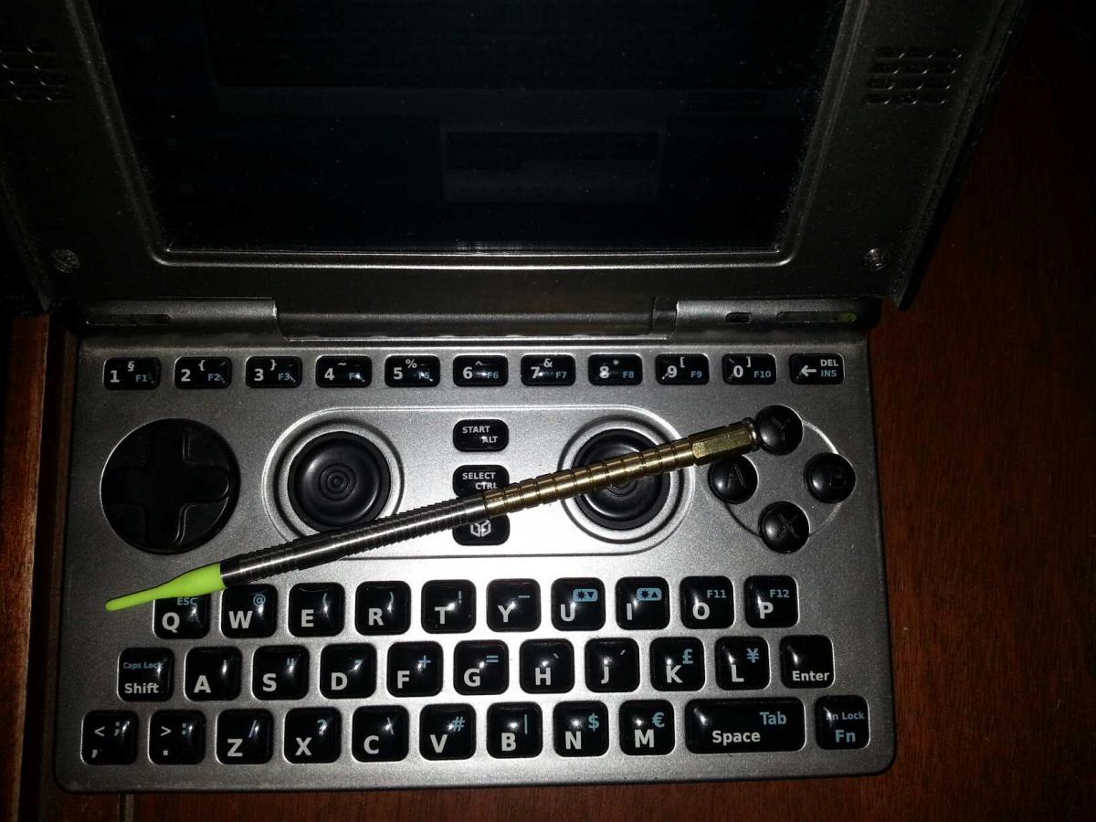

Progress.
1 drawback. Brass offsets may contain lead.
All of the above work fantastically as stylus. The one with the dart shaft requires kinetic input to remove from slot. The rest fit and retrieve fine.
My favorite twist on the theme yet.
@$50 in parts though.
Cheapest one above (all brass offsets) could be turned out cheaper than postage.
