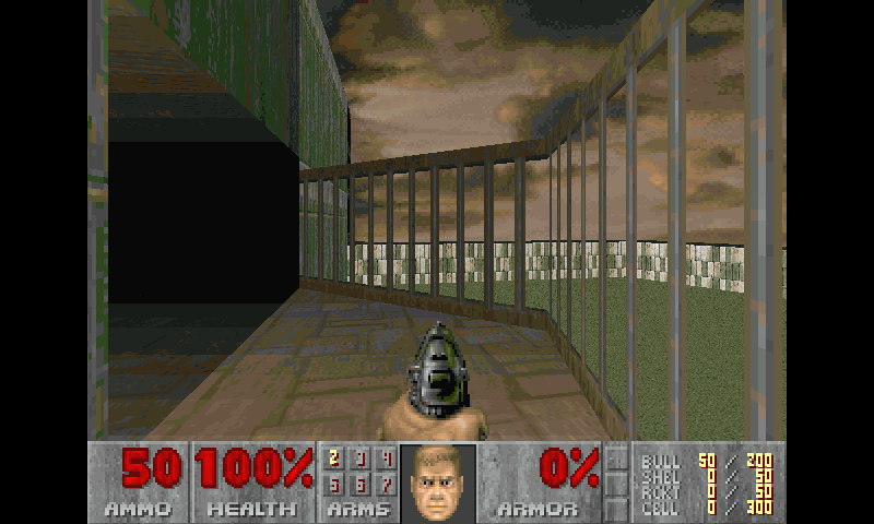

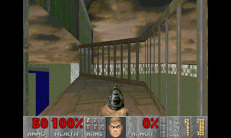

Here is a story of a bug:
I try as much games or program as I can to test the behavior of Box86 and now Box86 Dynarec.One of the program I tried was custom build of PrBoom. It's of course open source, so running an x86 version has no real value, except for debugging. And with the dynarec, while the game is now basically fullspeed (using software renderer in 640x480) exept with the meltdown transition effect (I guess it's unimplemented opcode in the dynarec, but I haven't checked yet), I noticed some graphic artifact in the looping demo. I started a game (Doom II), go back to grab the chainsaw, and sure enough, some walls were missing. I saved the game in a correct position, and tried again with Dynarec off, and yeah, interpreted version worked.
Having the source at hand helps a lot here. So using the basic technics of "printf stuff and compare to a reference", I tried to isolate a part of the init data where data diverge (between interpreted and dynarec). I thought this was linker to some of the Integer Math trick Doom use, so I started with "angle_t" math to go up to load of the BSP nodes to finish to a simple function "R_CheckBBox" (well, that took me something like 3H).

And I saw some divergense when in the part "one is behind us"
So now was the time to dissamble and trace what was doing Box86

angle1=7fffffff, angle2=67915800, clipangle=20080000
This is a box86 trace, running with interpretor, and with some added printf to better see where I am.
And now compare with a version with dynarec

angle1=9397e6a0, angle2=80000000, clipangle=20080000
See the difference ?
Now, before opening the next spoiler that contains the trace of the buggy emitted code, do you guess the issue?
Well, here is the part with the buggy code.
Code:
angle1=9397e6a0, angle2=67915800, clipangle=20080000

The emitted code is a bit complex here, because to code to emit the Trace is also emitted, and included in the trace. Debugging a Dynarec is a real pleasure...
So the issue is simple: in fact
That instruction: lea eax, [esi-0x80000000] is a bit special.
LEA means "Load Effective Address", and this is supposed to simply put esi-0x80000000 inside eax.
The LEA opcode is normaly LEA Reg, [Reg+Address], if I simplify. And the emitting code had some code to adapt to negative value to emit Sub instead of Add. The issue with 0x80000000 is that this is INT_MIN, the minimum value an int32 can hold, and this particular value cannot be negated! Int32 are from -2 147 483 648 and +2 147 483 647. So I code a special case for this one...
And now PbBoom works fine.
