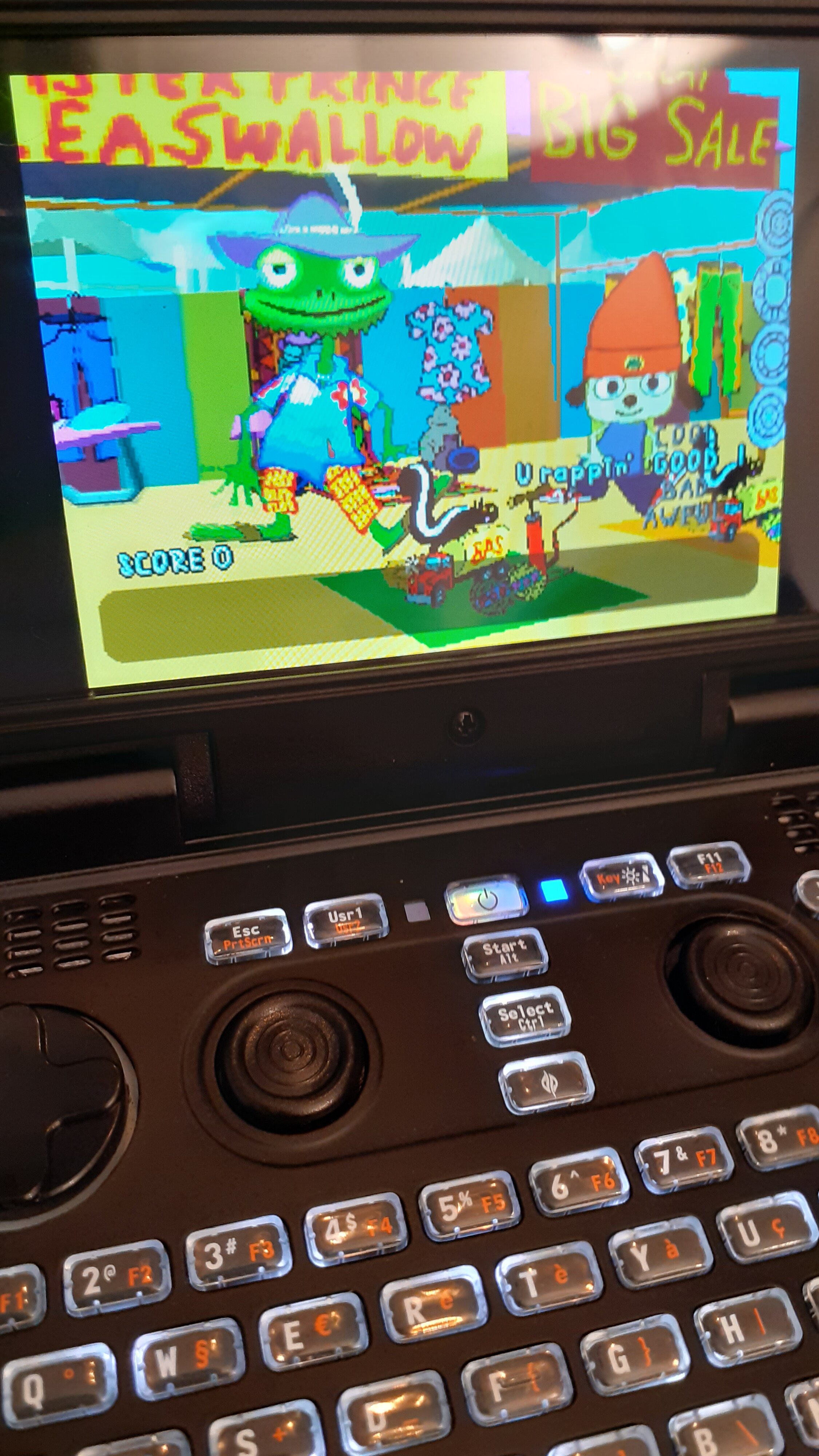

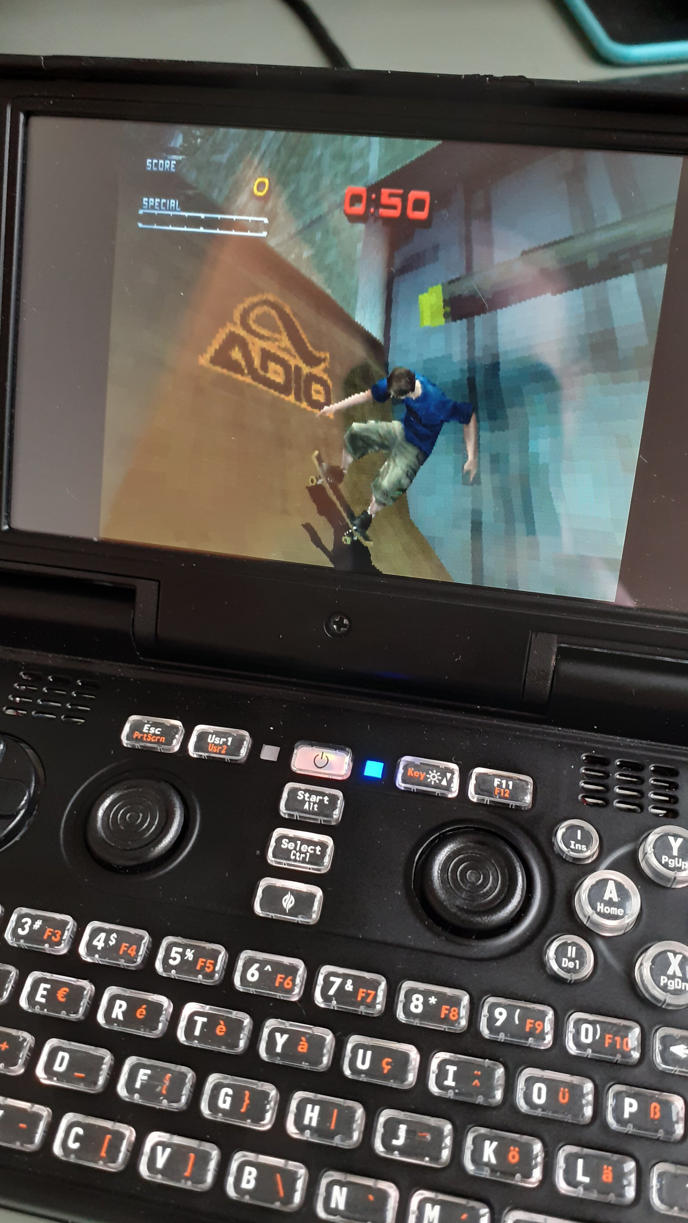

Tested a few more games and I'm not finding any problem. So far only wipeout and wipeout 2049 didn't work.
Test passed, awesome!
