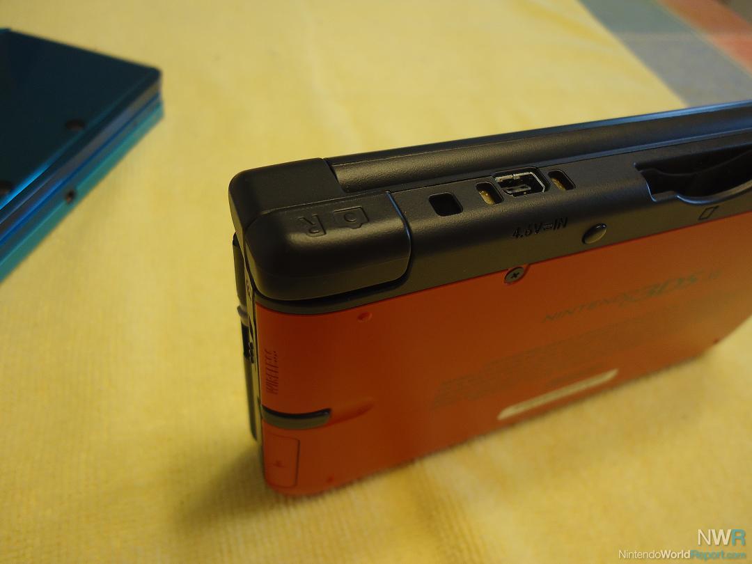

My opinion is two sized pairs for the Pyra could work. Something similar to the 3DS XL's for L1 and R1. Nice and big and resistant to shallow drops. For L2 and R2, about half the length of L1/R1 and placed on the back to the edge, like on the Gameboy SP, just above the larger triggers.
